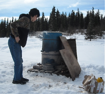

Thanks to advice I found on this forum and especially from Swiftone and Buckskin I made plans to do my own euro mount of my bison head.  After a lot of reading I decided on the boil and pressure washer system as faster and safer than others.  But I was stumped on how to get a pot big enough.  It finally dawned on me that I had some old 55 gal gas drums buried in the snow. My boy (13) has become a bit of a tool junkie and got an inexpensive sawsall this winter.  In about 10 min we had the drum sawed in half.  One part was to be the kettle the other the stove. I went to the dump for some raw materials and came home with some pipe and conduit for a stove grille.  With a few minutes of sawsall work we had had a hole for air and wood in on the lower base of the stove and some notches in the top for the grille pieces. I think we made the whole thing in less than an hour - a record for me.  Most of my "short" projects explode into days.
I wanted to get going on this thing before the brown bears come out and today was perfect.  Warm (34-37) and sunny and not to breezy to start.  I set everything up on the far back of our lot where a creek flows.  A pallet so the contraption wouldn't disappear into the snow.  Some concrete slabs to keep the pallet from burning. Fire wood and boy scout juice to start and a few gallons of water to start.  It worked well but the breeze came up and I had to put up some scrap plywood as wind breaks.  Started about 11:30 am.  Once going I shoveled snow into the pot until I had enough water to cover the skull then poured the heat to it.  If I had planned better I'd have take the head out of the freezer a couple days ago.  I had plenty of wood in tho and in about 2 hours the water was boiling.  I kept it cooking until about 7:30 pm  when the meat and tissue was  falling off on its own.  I scraped and shook a lot off, then back in the cooker for an hour.  Set up the pressure washer  (was getting cold again by then) and blasted the skull.  It was getting dark by the time I quit and my glasses were splattered pretty good.  I'll take a look in the morning when I have time and its a dried a bit.
The dog loved all the meat that came off.  My son shoveled a lot of the snow and bits onto the creek ice so hopefully the area will be rinsed pretty clean by the time the bears are out.  Funny thing, a local bear guide drove by on his snogo and asked what's up.  He's gearing up for the season so I guess its a good thing I got going on this.  My pressure washer is just a little electric unit but it did pretty well tho it splattered stuff far and wide.  Hope there isn't much to attract the bears by June.  I'm sure the neighborhood dogs will do their best to clean the place up.

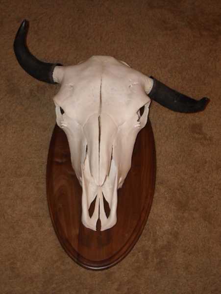

8-11-11  UPDATE
Was in Anchorage in June and found some peroxide gel at a hair place. You could get 20% 30% or 40%.  I tried 30%.  I smeared it all over and let it sit in the sun - when we had sun - the rinsed with water.  I couldn't tell if it worked much really.  Might not be the best way to go. But with intermittent sun exposure I got it as white as I could. Even ran some acetone over a greasy spot I found - seemed to help a little.
Found a nice walnut plaque through Walnut Creek Hardwoods.  They are real reasonable on prices, will use the mail (only way for bush AK) and pretty fast.
Got tired of the skull clogging my loading bench.
Trimmed and sanded a piece of  hemlock 2x4 to fit the back of the skull and painted it white.
At first I was going to glue it - well Marine Tex it.  But I decided there was enough bone so I bolted it with two 1/4 in bolts.
I can take it all apart to clean or improve if I need.
Screwed the wood block to the plaque, made a heavy aluminum hanger bar and now it glowers at my wife when she plays the piano.
Nice to have it done.  Saved a bunch compared to paying a pro.
But I appreciate even more, the amount of work, knowledge, and craftsmanship a good pro brings to the project. They earn their money.
And good work takes time.  A close look at this will show I'm not a in the leagues with the pros and have more to learn.
But I had fun and have a great reminder of a really fun hunt.
My regular camera is dead so could only add this one photo of the final result.
