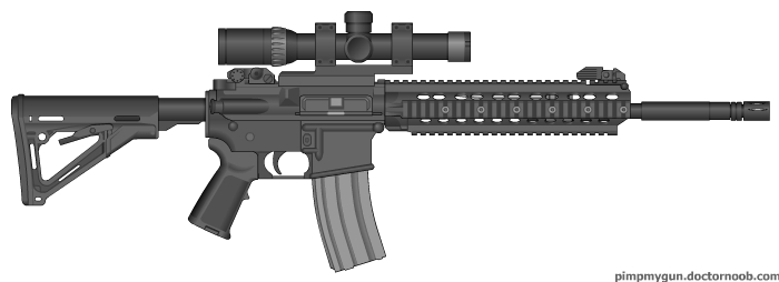

The short answer is yes.  The long answer is you will need to go to a free float handguard.  To do that, you'll need a low-profile gas block that will fit under the handguard.  You can't change the gas system length without changing barrels.  With this setup there's no need to put a false gas block with a pic rail for the front sight, just put a flip-up front sight on the handguard (make sure it's made for handguard height, not gas block).
Here's a pic of mind pre free float that should be similar to what you have.
Now here's a pic with the free float rail on it.  I kept the carbine length forend and factory front sight.
Now here's what it would look like if I decided to put a longer forend on it.  The only problem is the front sight/gas block.  You either have to replace it or cut it off so it fits under the forend.  A dremel works wonders for this.
Unless you get a Daniel Defense Omega rail, you will need to remove your delta ring and barrel nut, but this isn't too bad.  I did it, just buy the tool.
BTW, I used http://pimpmygun.doctornoob.com/index.php to make the mock-up.  It's a great way to play around with different configurations.

I think the easy answer it to just get a 20" upper and hang what ever you want on it.
With the popularity of the M4 and the shorty uppers the 20" uppers are going kind of cheap.

Just catching up....I think that the photo JMAYTON posted is close.  I'm looking to build a pimpy range gun really...just bored.  I have a bushy Natl Match with a Timney trigger and 4x12 Leupi for serious varmint/target work.  I'm looking to play around with the various parts.
I have a heavy barrelled CAR 15A3 with a straight barrel, not the M4 config.  I had a Colt LW SP1 with a pencil barrel and it was cool to look at but didn't shoot all that well which is why I went with a hvy barrel.  I'm thing of an ACE butstock to remove my standard stock and then a RR full length quad rail with a RR fold down front site/gas clock combo and a smith vortex break to replace the A2.  The current gun has a detach rear site with a trij insert front and back and a 2x7 leupi scope.
I like the RR rails (though they're a bit heavy).  The fold down sight/gas block is superflous and would just be attached to the barrel out past the forend and you'll still need the lo-pro gas block under the forend.  That's the reason for the flip-up on the forend.
And I like my 3-gun/hog gun whippy. . .and it'll still smack the gong at 600yds.   But it's all preference and I love seeing everyone else's setups.

I think Jamayton's picture is the best option, Extends the forend to what you want, allows you to keep the barrel in place and atach all kinds of gizmos to the rifle.  Including iron sights to replace the front sight if you removed it or replaced it with a gas block.  I like Iron sights on the AR- All battle rifles need Iron sights.

BTW, I told you wrong.  Well, sort of.  What you're talking about doing is called a dissipator.  Kind of like this:  http://www.bushmaster.com/catalog_xm15_BCWA3S16D.asp
It's got a rifle-length sight radius but a carbine length gas system, via a hidden gas block under the handguard.  it's an interesting concept.  I just don't think I'd have one, since a mid-length gas system with a full-length handguard would cycle more gently and be lighter.
