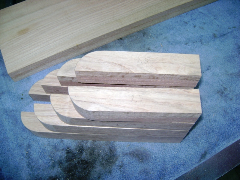

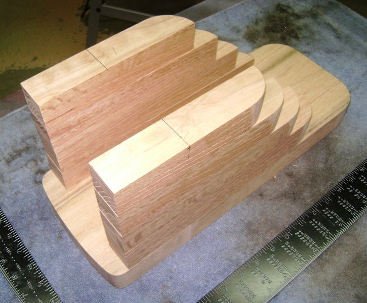

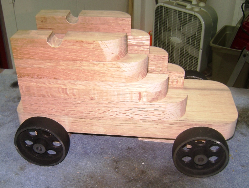

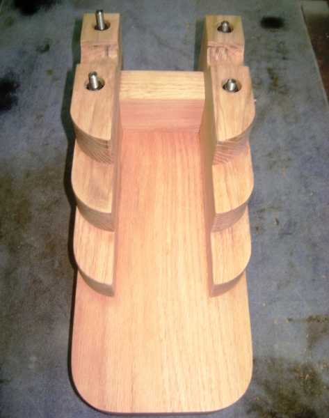

I am not modelling a specific carriage, but rather using highpoints and ideas from the tons of photos and drawings online, and in books like Round Shot and Rammers and such.  For size I am only going by general ratios based on barrel length.  (My barrel is 22" overall.)
I like the idea of scalloped steps, so I am using 1.5x1.5 laminated oak square stock for the side material.  The base is two pieces of 3/4 laminated together.  I've done some roughing out of the wood over the last couple of days:
The 1x2's across the bottom will hide the 1/2" steel axles.  There will also be a center piece inside that is not in the photos.

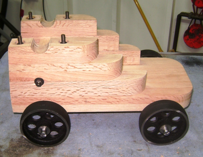

To get an idea of the looks, I shimmed it up and set the wheels next to it:
That brings you up to date.

looking good,  try to see what it would look like if you remove the top peice of wood on the carriage.  i think it would look better with the barrel sitting lower to the ground.  just a thought.  rickbryan
Re: New build around a 1/3 scale 6-pounder
« Reply #7 on: March 24, 2011, 10:20:03 PM »
I like the look of it, Mike; please keep posting photos of your progress.
Oh oh.  Now you've put the doubt back in my head.  I have kicked that back and forth for hours sitting in front of my computer toying with it in AutoCAD.  You have no idea how torn I am at that point.  Ships style is lower, garrison is taller (see my St. Augustine pics).  I guess I need to throw the barrel up on it and toy with it some more in real life.  Otherwise I won't sleep well.  Stay tuned.
« Reply #9 on: March 25, 2011, 02:15:23 AM »
But is HAS to be that tall to shoot out the back window!   :o  ;D

You might want to look into the idea of tapering the carriage to make it wider in the rear than in the front.

Concept looks good.  Just needs refined.
Cheeks need to taper front to rear.  Wider at rear than front,  like the taper on barrel .
Trunnion seats need to be closer to front-centerline about where the front of current trunnion seat is.
Needs upper cross bracing of cheeks.
The cheeks are too tall.  I would bet these few tall carriages you and I have seen were built to fit a small cannon in an already existing big embrasure.  I'll bet the regular carriage for for that embrasure was not tall.  Tall carriages look odd and will increase pitch up especially with heavier loads.
Offline Mike H.
  • Posts: 207
« Reply #13 on: March 25, 2011, 01:42:38 PM »

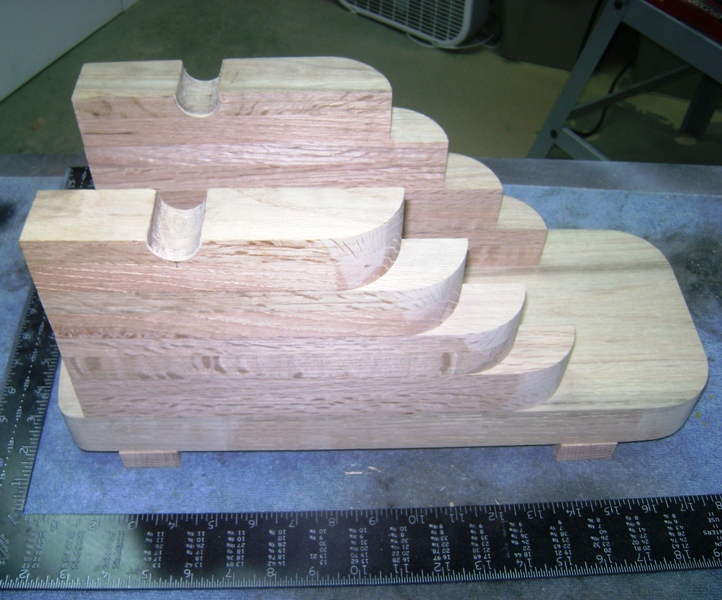

I plan to drop off the top level, and increase the length of the scalloped steps from 1.5" to 2".
I noted above that there will be a cross member between the cheeks, it was just not included in the photos as it is still rough size and did not yet fit without it all falling over.
I thought about the cheek tapering before I started, but the slim taper of the 6pdr did not, IMO, warrant the slight taper that would otherwise make the cuts and alignment more difficult.  We'll see.  I'd have to buy more wood and remake the base to do it now.
And the front of the cheeks will be tapered rearward slightly from bottom to top, to give it a slightly raked look - that is why the barrel is not more forward.

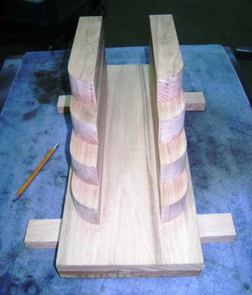

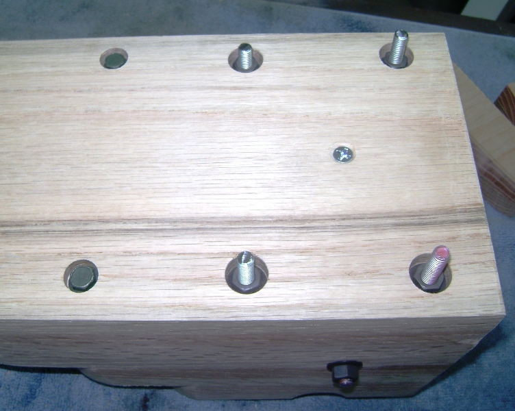

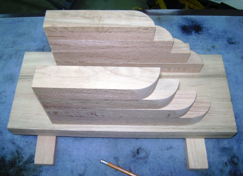

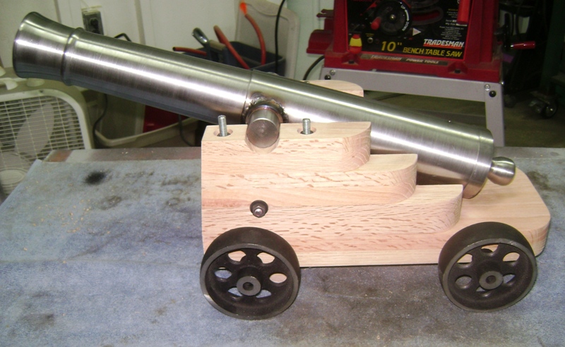

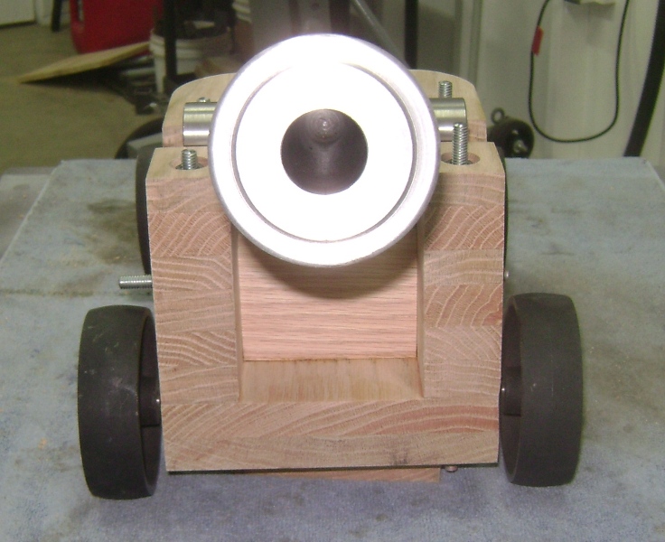

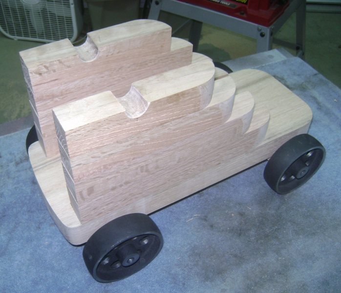

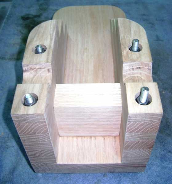

I have made some of the suggested revisions.  Dropped off the top tier, shortened the carriage length, tipped back the front angle of the cheeks.  I can NOT make further changes to other than the axles and trunnion caps - the main body is all glued now.  Again, I am NOT going for historical accuracy, just a nice looking carriage that is very strong.
The threaded rods you see now are plated temporary fillers, not cut to length.  The permanant ones will be stainless.  (I will replace them one at a time.)  All hardware not already black oxide will be painted flat black (such as the permanant stainless rod ends).
The vertical 5/16 threaded rods perform double-duty.  Along with glue, they hold it together vertically, and also will secure the trunnion caps.  That is why the top nuts are resessed.  Bottoms are resessed to prevent sight from the sides.
In the photos the carriage is shimmed up with the wheels set next to it for scale:
In my shop, there is a slightly low spot on the floor where my equipment mounted on casters does not make good contact at one wheel and can slightly rock.  That has given me the push to do the floating rear axle, as has been done on here previously on larger guns, to help prevent teetering on uneven surfaces.  5/8” square tube will reinforce the 1/2” round axle where I have to drill the pivot point, and I will split a rectangular tube to use as the axle hanger.  The entire assembly will be shrouded in oak.  Metal for that is on order from Speedymetals.com, as is the stainless 5/16 threaded rod and metals to fab the trunnion caps.  Once that gets in I can keep going.

...I think the front transom (the piece between the cheeks) looks a lot better when the top is cut out to follow the curve of the barrel. ;)
I agree.  But I did not have a saw that would cut that curve.  (Band saw is a hard sell to the wife, but still working on that.)  Can't readily be seen unless the barrel is off, or carriage is elevated, or you lay down on the floor to look under the barrel.  At this point it's hindsight - it's all glued.  All I can change now is axle designs and finish.

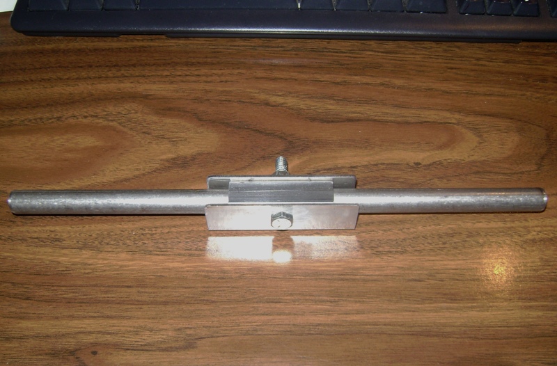

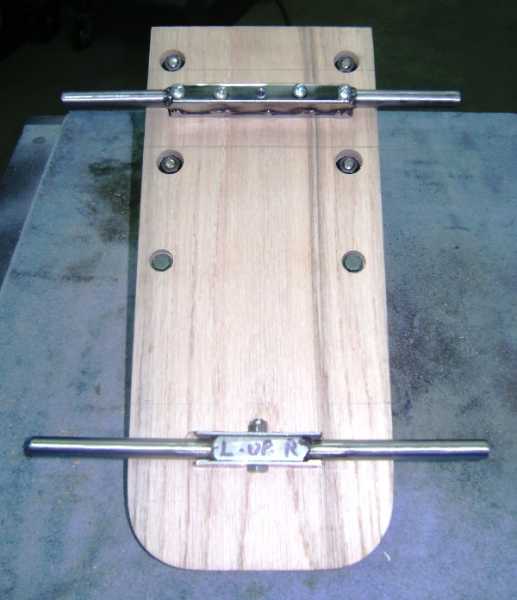

I had only a little time over the weekend, and with that I replaced all the cad-plated all-thread with the stainless.  All is cut to fit very nicely and threadlocked.

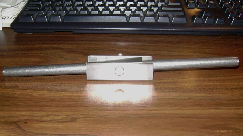

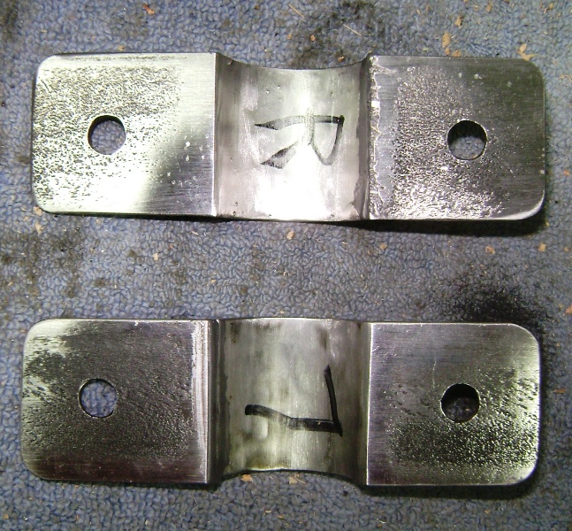

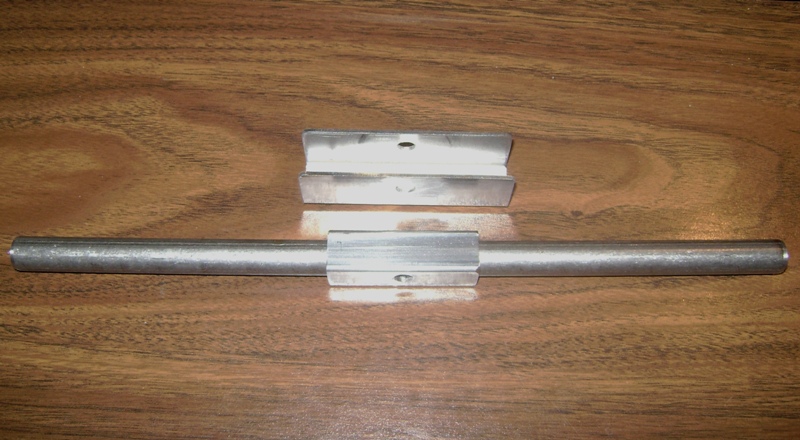

Tonight I had a little time, so I started the metal work.  I cut the axles to length and put together the rear floating axle assembly.  Not much to that at all with one this small, as you can see in the pics:
I will be welding the inner square sleeve to the 1/2" axle shaft.  The through bolt will be grade-8 with permanent lock-nut.  And the entire assembly will be recessed and encased in oak.  That will be some time with the router and Dremel.....

Did consider doing othe the way of the originals?  Make the axles smaller than the holes. Wheels on the this type of carriage don't need to be a tight fit.

Lets See if I can explain this axle concept for you...let me use the  SAMCC axle and wheel combination as an example.
Make the axle diameter  1/2".  Make the hole in the wheel 5/8".

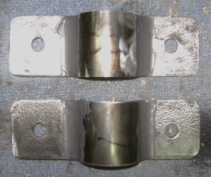

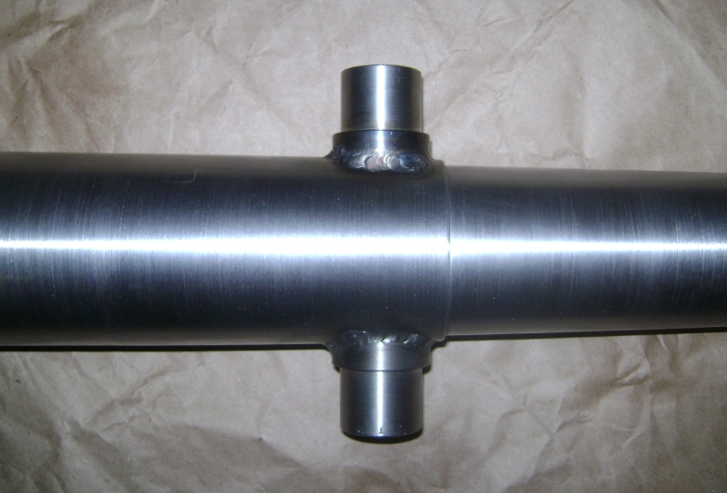

Another weekend passed, and a little more done.  Saturday I finished up the gross metalwork.  Only final sanding and prep/filling to do.

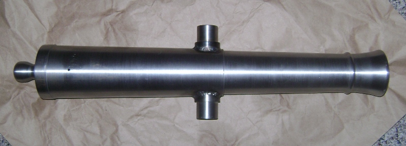

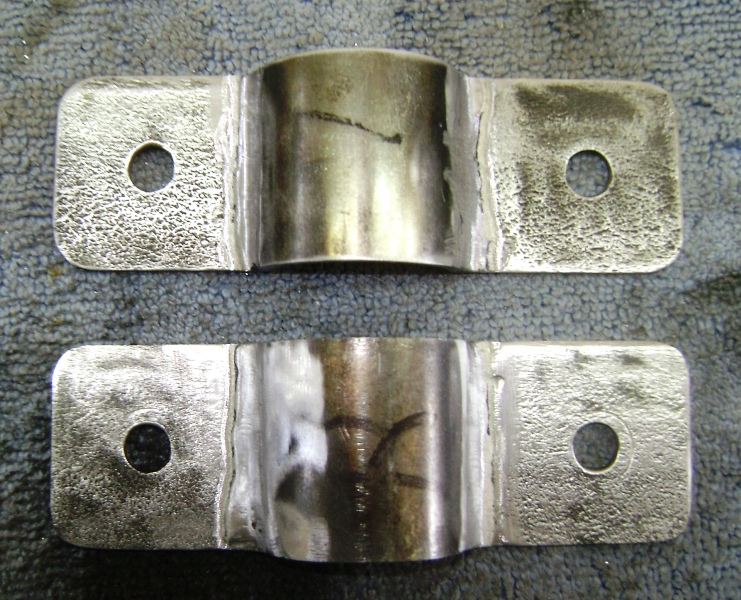

Got the trunnion caps done.  1/8" flat stock and 1/8" wall DOM fitted and welded:
After grinding the welds, I coated them with JB weld using the radiused end of a popsicle stick.
Now all I have to do is final sand, fill the pits in the steel with sandable primer, and paint.

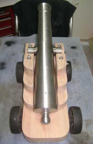

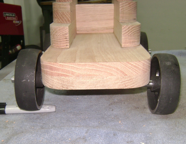

Tonight, I attached the steel axle assemblies, including the floating rear axle with hanger.  Please keep in mind that these will be completely encased in hand-fitted oak.  The bottom will not look like this when completed:
So now I have something to finally slip the wheels on for a test look.  The wheels are not pinned on yet, but I had to play a little:
I know this is not a Jeep forum, but I could not resist a shot showing axle articulation:
