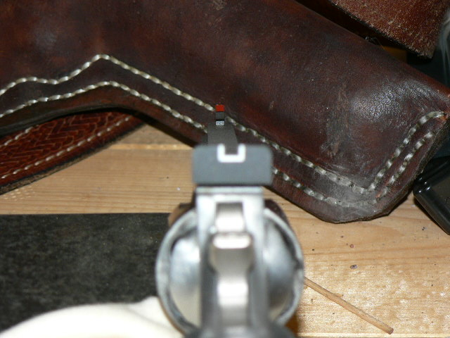

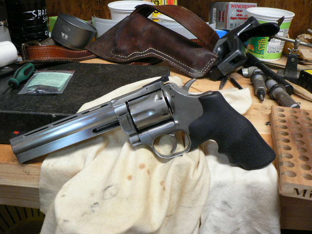

New rear sight finally got here from Bowen Classic Arms.  Installed the day it arrived, 5 minutes total.  Sighted in today.  Works great
See attached pics of sight.  Flat black, matching front sight.  White outline sure helps these old eyes.
