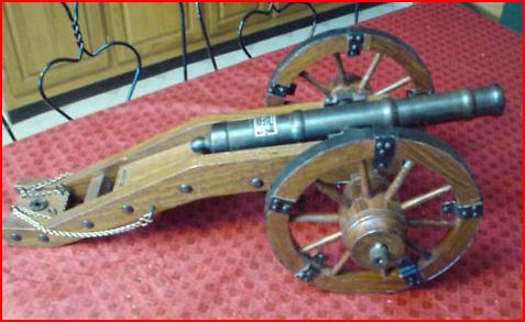

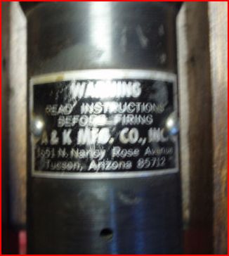

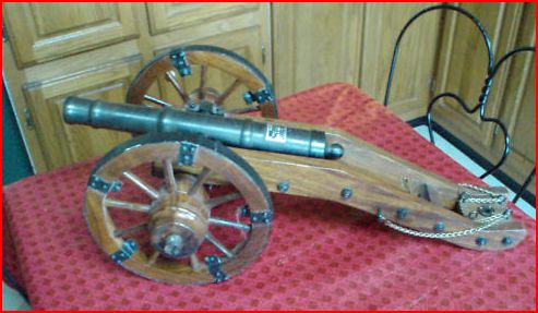

Welcome aboard! A & K MFG. Co., INC. out of Tucson, AZ made four models: An "American Revolutionary Six Pounder Field Cannon," "Naval Deck Gun," "Dahlgren Gun With Marsilly Carriage," and a "Coehorn Siege Mortar." "All barrels are made fom solid billets of steel. There are no welds, press fits or dangerous castings used in barrel manufacture." I'm copying this stuff out of their brochure, and there's also a picture of a guy of 300+ pounds standing on the field gun with a caption that reads "These Cannons Are Darn Tough!"
If a small steel cup with a brass pointed rod coming out the bottom came with your gun, that's the powder measure and vent prick. For obvious reasons their suggested load for the field gun is 50 gr. FFg.

Let me try the pictures again.  And thank you all so much for your help so far. I feel a part of something BIG!
BoomJ  Thank you so very much for your info.  I really wish I had found this site before last night!  So if this is all steel with no welds, would you say if all is in good condition, this should be OK to fire?  If you ever get near a scanner, I would love a copy of the brochure, as I hope to pass this down to my one and only grandchild someday.  (My wife thinks that day should be sooner than later, and is suggesting my cremated remains be stuffed in the barrel, complete with fuse ready to go!)
