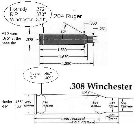

(A rainy day project) after reading Ololique's Reply #17
This thread concerning brass bulging in Handi rifle chambers had me checking some brass measurements on two calibers, .204 Ruger and .308 Win.. All new brass taken with 5 random cases in each brand.
With the actual measurements taken vs. the specs shown on the two caliber case dimensions plus the tolerences allowed in the Handi chambers or any chamber for that matter, one would expect some degree of bulging in their fired brass as shown in the OP's picture, some more than others.
Looking at several other calibers, I do notice that Winchester brass seems to be consistanly on the low end in measuring the two spots on the cases.
Nosler brass has bulged the least in my Handi rifles, at least in my experiences.
