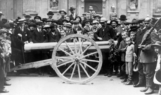

From the video it appears that the front barrel lugs help guide the barrel while recoiling.  I have not found a definitive answer as to what their purpose is.  Here's a photo of a 75 with the barrel in the recoil position.  Maybe the front lugs supported the barrel while the cannon was transported?
It appears to be a captured gun - German soldier in the front right of picture?

I have never found a detailed description of how the lugs at the muzzle work, but since they only come into play when the barrel is at full recoil, their purpose must be to retard or stop the barrel from coming off the carriage if the recuperator looses air or oil pressure.
The picture of the 75 with the barrel in full recoil probably had a failed recuperator, maybe that was why it was captured. The barrel should not be in this position if the recuperator is working properly.
