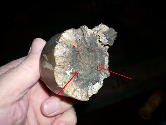

Took a few days going through my Dad's stuff in Atlanta (he passed about 10 years ago and my StepMother last July) before the house is sold in the spring.  Made a find - something I've been looking for now for some decades.
These pictures will raise more questions than can be answered.
We (us kids) loved shooting the cannon, so this was a warm up on one 3rd of July.
Obviously too much of something - packing, powder - can't go back and ask.
1" bore, 3" OD.
All of us were staning BEHIND the canon - best place considering.
THere were 1" pieces that cut the turf for 70 of my 1 meter paces.
Only two small injuries - my brother caught a microscop8ic piece in his shoulder - the operated 3 tiems and never found  it.   I caught a pencil lead size 1/8" long in my finger and found out about it  3 YEARS later when it worked itself out.
Som will say luck, I say God's grace for our stupidity.

  Is that dark area of the breech nearest the bore where it began to fail several shots earlier?
Re: Kaboom - cira 1961 or so
« Reply #5 on: December 27, 2010, 04:48:59 AM »
I'd say that the angels earned their pay that day!!!!
YUP   ;D :D
« Reply #6 on: December 27, 2010, 04:50:22 AM »
I would draw that conclusion.  Maybe started years or decades before.

My first impression was brittle fragmentation....then I noticed what appears to be the vent at the top of the breech which looks like it  expanded to failure and not fragmented....are these pictures of the remaining fragments after the failure, or are these pictures of the fragments that you just just took after finding the them in your dad's estate?
Do we have  a destructive test analyst in our midst?
Tim, is that brass or bronze?
« Reply #15 on: December 27, 2010, 09:52:04 AM »
This is the only piece left.
Yes, it looks like it broke along fracture lines and yet one large piece next to the vent hung on ....
As Dom pointed out - the darkened area was likely an old injury from yesteryear.
The vent was large enough for standard dynomite fuse.  (7/32 dia ?)

is it really a bronze barrel ??  or could it be brass ??
it looks a little bit too yellow for me to be bronze that havent been claned or polished for at least 50 years
I think it should be a little more to brown in color , but it might be because of light or flash also
the dark area is without any doubt an older crack that been filled with soot and other residues during firing it
the bottom of the bore seem to be totaly flat , and the crack seem to have started in the corner between the bore wall and the flat bottom
that show how important design is for a cannon barrel
Ive never seen a bronze barrel shatter like that

On the outside the color is a deep brown in most places, more brass/bronze in others.  I've never know it to have been polished (since 1957 or so anyway - and I'm sure it wasn't used for some 20 years before that).
The bottom of the bore is a hemisphere -  might not show well in the pix.
The vent looks quite enlarged at the bottom too.

Now the question is:  could this have occurred with a nominal load - like (most) all of those prior - since the darkened area indicates prior fracturing.
That raises a serious issue - that of relying on using 'moderate' charges and FEELING safe.
And, then, another question, could the cracks have been detected using a wire 'feeler' or other simple techinques or would it have taken xray technology?

Agree with that being the weakest area.  In mine it's interesting that there is blackness (indicating prior fractures/corrosion) all the way around AND the deep cracks into the hemispherical end.

Is this the rear most part of the bore? [arrows]  This edge looks like a stress riser.
« Reply #28 on: December 27, 2010, 11:36:15 AM »
Yes, and that was my thought too!!
Note the id of the vent top and bottom.

I don't think the darkened  area is a definitive indication of prior fracturing, Sooting could be a by product acquired as the metal failed.
