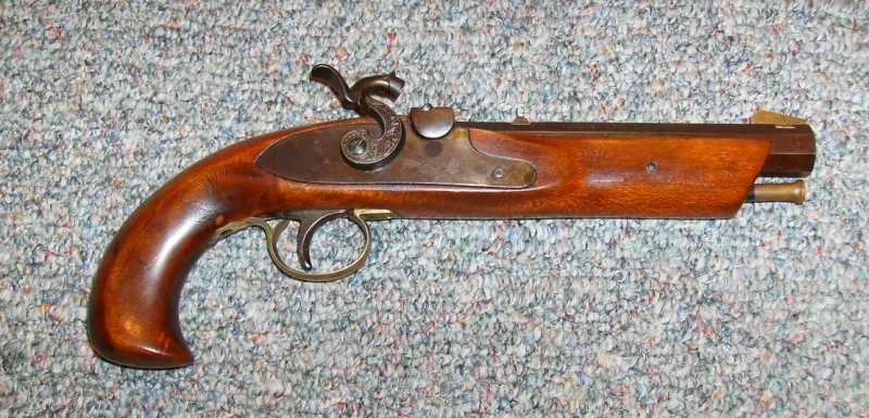

.54 Lyman Plains Pistol Kit
« on: December 07, 2010, 07:04:22 AM »
This is the first kit I have done. I browned the barrel and all metal parts. I also blackened the brass and gave the stock an aged look. Should be a good grouse/rabbit gun with light loads.

Nice!  I have GOT to make me one of those!  What load do you use?  I'm thinking deer here...  ;D

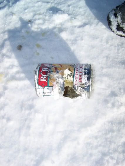

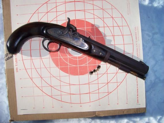

AtlLaw, I'm shooting a .530 patched round ball with pillow ticking over 40 grains of Goex 3F black powder. The max charge listed for this gun is 50 grains of 3F. These are the first shots fired at 20 yards from its initial trip to the range. It was cold with gusty winds so I think the gun is capable of grouping better. I'm not going to mess with the sights until I send 50+ rounds down the barrel.
Someone had left a can of applesauce on the ground so I decided to see if I would get any expansion from the round ball. Knowing about where to hold from my shots on the target, I adjusted my aim and shot the can at 20 yards. I was impressed with the exit hole through the frozen applesauce. If I'm going to use this gun for small game I'll have to reduce the powder charge quite a bit. At close range I think it would be fine for deer.

Impressive!   ;D  Maybe a little longer barrel for 50 or 60 gr...  :-\  Heck, If I don't have any quams about trying my Dragoon with 40 gr. at 20 yards or so, why not!   :D

I have one with both the .54 and the .50 barrel. This is one of the most accurate pistols I own including modern ones.

what'd you use to darken the brass? looks  pretty good and might like to try it. thanks friend, bubba.
I used Birchwood Casey Brass Black. Its easy to use, just apply it, let it sit then wipe it off. I did several applications for a very dark finish. I used Laurell Mountain Forge browning solution on the barrel which was also very easy to use.

Nice work, makes me wanna buy one again since I sold my last one in .50, it was'nt kit mind you and because it was .50 not .54 like all my sidelocks I sold it because it did'nt fit in with the rest lol.
A kit in .54 is in order me thinks.

Nice lookin' GPP.  Here is the .50 I finished this weekend but I have not fired it as of yet.  I also made the patch knife and the Possibles bag just for fun.  I hope mine shoots as well as yours seems to be.  Dang this is addictive.

Very nice groundhog, I need to finish up on the deer season (this weekend will be the last)...Then continue to harrass those Coyotes...and possibly have time to complete a kit (yet unpurchased) with hopes of it being done in March?
pab1 & groundhog 107, taking your time, and taking care, how much time did you spend assembling and finishing this kit?

Ok, I am gonna take a stab at this.  I am a notorious "piddler" so I spend a lot of time doing what others could accomplish in half the time.  So with that being said, I would say that a person could easily complete this kit in one week althought it took me two.  The most time consuming part is the barrel finish (browning in my case) and believe it or not, the sanding/polishing of the sand cast trigger guard. Building a browning box sure speeded things up for me, I can help you with that if you need it. The stock is mostly finished and only requires some final shaping and smoothing the inleting is very good. When I say a week, I dont mean a 40 hour week, I mean you spare hours after work.  There is a lot of time waiting for something to dry if you know what I mean.  I hope this helps, and if I can be of any help, please dont be afraid to ask.

Groundhog pretty much summed it up. Waiting between applications of the browning solution and coats of finish to dry is the most time consuming part. Building mine during the summer meant it was put on the back burner for quite a while so I could take the fly rods out. The Lyman kit could pretty much be assembled and shot right out of the box but it wouldn't be pretty. You could rush through it or take as much time as you like. I recommend taking your time and checking the wood to metal fit often when sanding/shaping the stock. When draw filing the barrel be sure to chalk your file and clean it often with a wire brush.

While its just my opinion, I think you would take imeasurable pride in something you finished with your own two hands vs a factory assembled gun.  There is a certain comfort in knowing all the flaws and you can do it anyway you desire.  That is the addiction that we all fight here or so it seems to me.

Very very nice pistol. I have recently retired and this looks like something that I would love to do. I may contact you for tips on the browning process as I love that finish.

i have been looking at the 54 for years. yours looks real good how is the fit on barrel and lock? i have two rifles in 54 they really thump a deer hard complete pass through with buffalo ballets i like building kits. never tried alyman got to be fun have great week end.

I built a .54 from a kit about 15 years back. As I recall, ALL the inletting was spot on. The only difficulty that I have with this gun is that the "reach", the distance from trigger to back of grip, is a might too long for my stubby fingers. I can shoot it, and shoot it well, but wouldn't be my first choice for competition due to that ergonomic mismatch. Someday I may try reshaping the stock or even having it restocked. At that point, it would be my favorite everyday percussion pistol.
