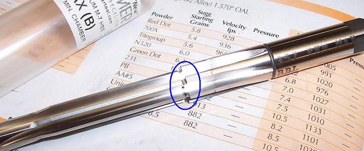

My 357 maxi that shoots lights out has been an on going problem created by me, I think.  I think I cut the rim deeper when I reamed the barrel to maxi.  I have had FTF's and have used the extractor, (ground off the face and shimmed the back) to hold the brass at the proper headspace to prevent the FTF's.  Has worked ok for about 30-50 rds.  Today the rim edge of the extractor broke off, I guess from the fact it was holding the brass out somewhat away from the bottom of the rim cut.
Here are the questions.  Should I redo the extractor the way I had it, or should I go ahead and bite the bullet and grind down the barrel face to reduce the depth of the rim cut and reshim the barrel?  Or is there another repair better than these, short of sending it in for a new barrel?
Any advice welcomed.

I would think a machine shop or gunsmith could make a sleeve for the back .250 or so of the chamber and then you could recut for headspace. A sleeve would be as strong as the chamber and would support the brass. If it fits tight, that would be my first choice.

That is the down side of holding the cartridge back with the ejector, I have also had that problem using that solution on a 17 Velociraptor conversion, fire enough rounds through it and that will happen.  You may take a good small center punch and punch the face of the rim cut in about 6 places around the chamber.  It will move the rim back by .005 ot .008 or so depending on how hard you whack the punch.  First you really need to measure what you have got as far as head space.  Someone needs to round off the edges of that maxi reamers rim cutter so someone else doesn't do the same thing.  Larry

12 or 13 is more than you want to have but it really isn't too extreme  especially with a straight walled case.  Check the fireing pin protrusion, I get about .055 on mine and I think that .065 would be just fine.  Larry

.045 is not enough for sure, especially if you take away .013 for the headspace.  If the thing that is stopping the fireing pin is the stop on the hammer hitting the frame, then just take some metal off the hammer until you have about .055 to .060.  I would be very surprised if that didn't fix it.  Larry

I agree with Larry on modifying the hammer.  I took a needle file to mine and slowly removed metal then tried primed cases until the firing pin strike looked decent, then I tried loaded brass.  Problem solved for over 200 rounds so far.

Re: excess headspace cut.  Back in the day when we found excess headspace on a shotgun we would machine a good steel washer and solder it into the rim groove, then use the chambering reamer to carefully recut the groove to get the correct headspace.  Permanent fix and easy.  Here endeth the lesson.  Goatwhiskers the Elder

That's not a bad idea, but there have been a few members that cut new chambers with my reamer which makes it more valuable to GBO, so I won't be doing it to mine.  ;)

When I chamber a new barrel for a rimmed cartridge, I do the rim cut first using the lathe, get that to the right depth, then run the reamer in until the rim cutter touches the already cut rim.  It is very easy to cut the chamber too deep if you are using the cutter built into the reamer.  Just look at all those factory H&R barrels that have deep rim cuts.  Larry

Although I have never done one, you can likely stop cutting the maxi chamber several thousanths before you touch the rim and be just fine.  I would start checking the fit about .010 inch out.  Larry

I am probably somewhat below average in mechanical skills, but I followed the directions that came with Tim's reamer. I stopped reaming when the first tiny scratch appeared on the rim cut. The reamer is much sharper and cuts much faster than I expected, so I rotated the reamer with partial revolutions at a time, and pulled it out to clean off chips and add oil about once a full revolution. Tim's reamer came with a 357 Max case, so I dropped it into the chamber each time after I cleaned out the chips to check progress. When the scratch appeared, the rim of the case was  seated flush with the barrel face. I looked inside, and there were some burrs at the muzzle end of the chamber. I was tempted to give it another turn "just to clean things up a bit". Instead I inserted a .40 cal bronze cleaning brush, and gave it a few turns. The burrs were gone, headspace was still good, and it looked nice and "cleaned up".
So far it has had no headspace or FTF problems at all.
