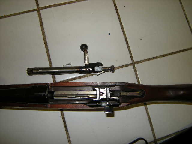

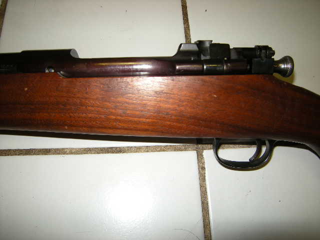

Tried looking for advice in a milsurps forum, no reply, maybe you guys can edjumicate me.
Serial 39333**
Has an odd compensator
Bishop buttplate on stock

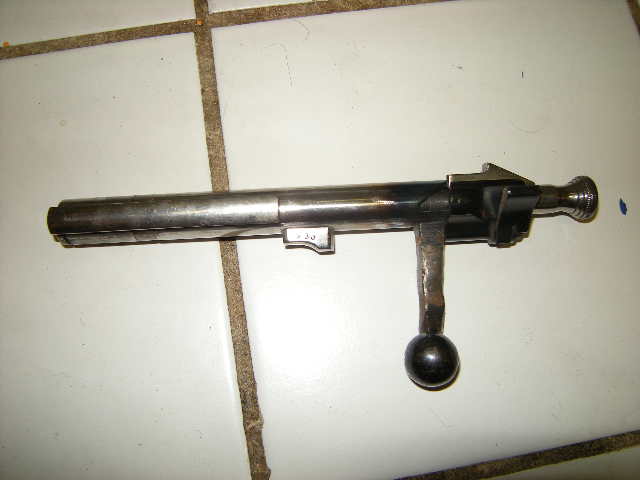

Bolt is chromed or polished and marked S30
Bolt has been beat on to function in a non relieved stock, it looks like there was some stock repair in that area.
Bore is perfect.
Should I replace the bolt to shoot it? I want something that will work with the stock. I M2 ball to feed it, but will to reload if headspace is an issue.
Is the old Redfield mount for the 1903A3 the recommended one? I 100% want to scope it.

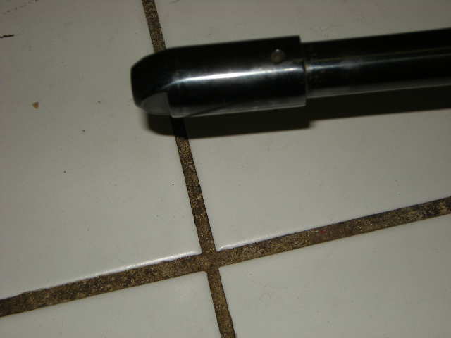

Receiver is drilled & tapped (see 2nd pic). Drilled and tapped for what I am not sure about. There are only 2 holes.
The bolts are supposed to be fairly easy to swap and I see bolt bodies on GB, ssporters, etc for $10-20. The hard part is picking a bolt and possibly cutting the stock.
I read a used primer/new brass trick for measuring headspace that does not seem dangerous.
The serial number range is well over the 800K low serial number cutoff. Not sure how a smith would check receiver hardness.

Sportsmans guide used to have complete 03A3 bolts for about $40.00. Buy a complete bolt and go from there. From the heat discoloration on your bolt body probably used either propane or oxy- actelene torch and I would definitely be concerned about possibly messing up the heat treatment. Strip the old bolt for parts and trash the old one. Have a gunsmith check headspace with the new bolt.
Darn, bubba really messed that bolt up. The rest of your rifle looks ok though. Frank

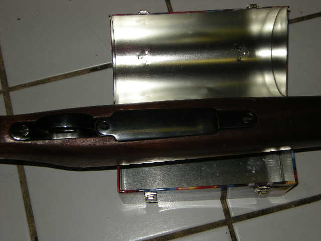

Offline AtlLaw
  • Trade Count: (58)
  • Posts: 6501
Re: $99 A3 sporter
« Reply #6 on: December 02, 2010, 03:27:30 AM »
Serial 39333**
Remington made in 1942.  Serial number range is not an issue as all A3's were nickel steel.  The bottom metal doesn't look like A3 stuff though.  Can you post a better picture of just the bottom metal?  Just for my own curiosity...  :-\  You already got a great deal, If Bubba replaced the stamped bottom metal with Springfield or RI stuff it just got a whole lot better!   ;D
Unless it's the picture, it looks as if Bubba may have put a torch to the bolt to help in the bending... without a heat sink!   ::)  Oops!  I see that Frank has already pointed that out.   :-[
As others have said, new A3 bolts are readily available.  If it were me, which it ain't darn the luck   :'(, I'd trash the old bolt and get a new one.  As was also said, the reciever alone is worth what you paid for the whole thing!    ;D  And do have the headspace checked or do it yourself.   ;)

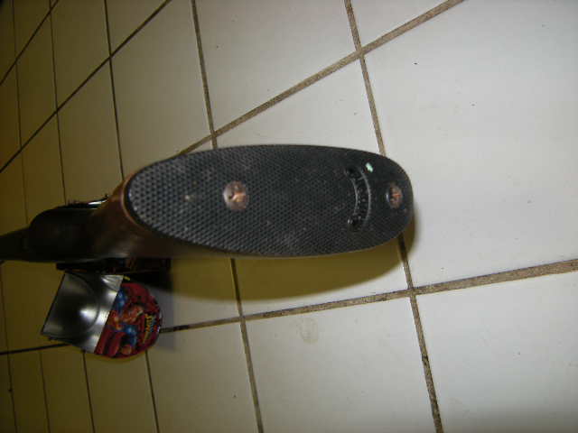

« Reply #7 on: December 02, 2010, 05:36:24 AM »
Some more pics. The buttplate says Bishop.

« Reply #8 on: December 02, 2010, 06:28:56 AM »
My bottom metal looks like this guy's (though his gun is much nicer). What is 01 bottom metal?
http://www.snipershide.com/forum/ubbthreads.php?ubb=showflat&Number=2115379
Offline AtlLaw
  • Trade Count: (58)
  • Posts: 6501
Re: $99 A3 sporter
« Reply #9 on: December 02, 2010, 11:02:27 AM »
Beats me.  Probably a typo.  I'm sure he meant 03.  I could take a picture of the bottoms of my '03 and A3 side by side and you could easily tell the difference.  A3's were terrible looking stamped stuff.  You have 03 bottom metal which is a definate plus!   ;D
I don't think there is much doubt that the stock is a Bishop.  I understand they sold bunches of them when everybody was "sporterizing" '03's, 03A3's, Mausers, etc.
Look pal, you didn't do good, you done GREAT!   ;D  Get a new bolt body, have the bolt handle bent or replaced, inlet the stock for the bolt handle, check the headspace and SHOOT THAT RIFLE!!   :D  Or, I'll give you $150 for it, shipped of course!   ;D

     Many years ago my son got an 03-A3, that had a bad bolt.  He bought a complete new  bolt from Numrich Arms for about $38.00, and a had a gunsmith fit it for about $60.
     He never had any problems with it.  It is definitely the way to go here on your rifle.
    Don't fight the obvious.   Don't try to re-invent the wheel.  Don't risk a huge safety issue over a $100 or so.   Buy a new bolt and have it installed.  Throw the old one away.  You will still have a great rifle at a great price.
