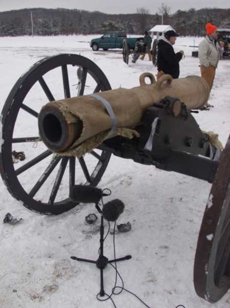

When we were doing the sounds for Master and Commander we blew out a couple of the mikes placed near the 12 pdr Napoleon.
Good to know!  How far away and what orientation?
This is the placement of the mic on the 24 pdr howitzer after the mic got blown earlier on the 12 pdr Napoleon.
Offline gulfcoastblackpowder
  • Posts: 808
Re: what makes a cannon loud?
« Reply #14 on: November 27, 2010, 10:14:35 AM »
Wondering why the cloth is taped on the gun...   ??? (I could guess, but I'd probably be wrong.)
Offline Artilleryman
  • Posts: 1378
« Reply #15 on: November 27, 2010, 10:25:44 AM »
Bronze smoothbores make a ringing noise as the projectile leaves the bore.  In the movie all the guns are iron guns that do not make that sound.  So to be as authentic as possible (sound wise) we wrapped a piece of carpet around the chase of the barrel.  We also had to tape down all the moving metal parts that made clanking, rattling noises that you would not hear from a gun truck.
« Reply #16 on: November 27, 2010, 11:13:52 AM »
Ooooofda!
THAT's CLOSE!
  • Posts: 1378
« Reply #17 on: November 27, 2010, 11:33:55 AM »
They also had a larger mic located to the side and rear of the piece.

I think there are a few reasons the ball would bounce:
1: The ball is slightly rolling out the tube due to elevation - unless the gun is pointed at exactly 90* to the Earth, gravity will be acting on the ball while the powder does, keeping it wanting to roll out the bottom of the bore as it is being pushed by the powder.
2. Inconsistencies in the ball and bore surface - as you mentioned, there are no truly smooth balls or bores.  They can be very smooth, but there will always be some variations - if nothing else, fouling, which will tend to interfere with the ball's desire to maintain a rolling position on the bottom of the bore as described before.
3. Inconsistencies in the packing and powder - even just a small deviation in how the powder is packed could cause a difference in the loading of the force it generates on the ball.  If the loading isn't exactly colinear to the bore, it will tend to induce spin on the ball, which will magnify the effect described in #2.  In fact, even if the pressure does act colinearly to the bore, gravity acting on the ball will still tend to induce rolling, as the net forces will be slightly downward.
4. While rolling OR sliding, a 3rd force is acting on the ball - friction.  Because friction force will be higher where contact between ball and bore is predominant, it will tend to slow down the ball on the bottom, while the blast continues to push - in fact - overpowering the friction to the point that the ball bounces off the bottom of the bore.
This bouncing is eliminated in rifled bores because the rifling holds the projectile tighter, forcing it to have a controlled roll - in the form of the rotation it imparts.
As far as the resonance sound between rifled and smooth bores, I haven't done a direct comparison, but I'd have to guess that the smooth bore will be louder if for no other reason than the rifling will limit the amount of vibration the cannon can sustain.
