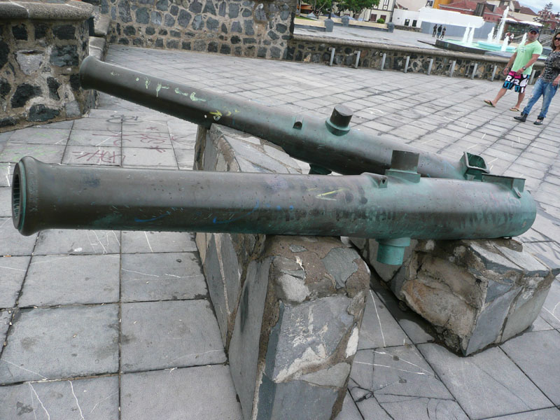

While on holiday last week I happened to find a pair of rifled cannons to photograph and thought they might be of interest.

Where are these located?  What are the rectangular things on the breech?

They were taken in Tenerife, in the north of the island, in Puerto de la Cruuz.
I thought someone would notice  the rectangular things on the breech, that’s what got my attention.

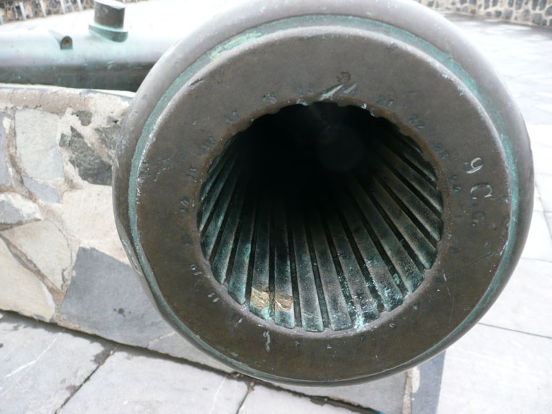

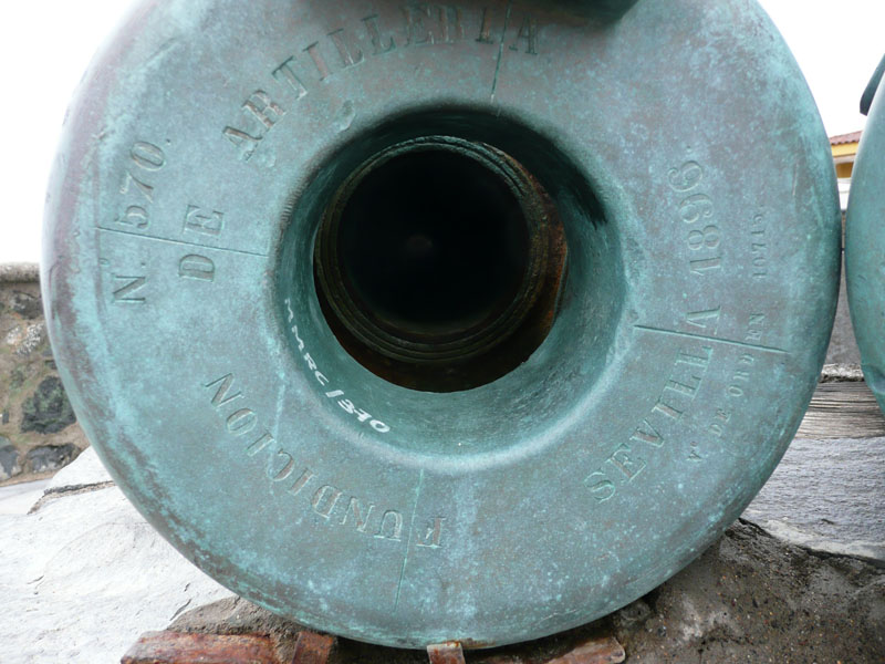

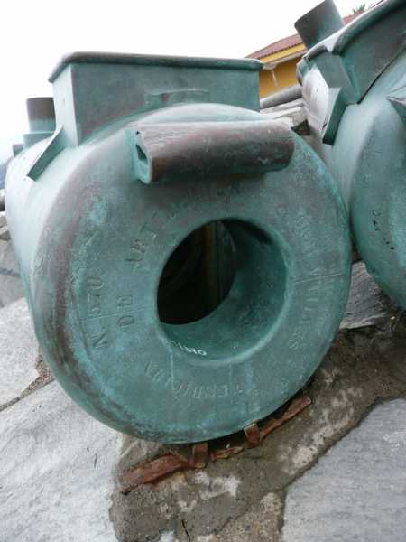

It is definitely an interesting piece, the rectangular projection contained the sliding breech block, and the muzzle face has each land of the rifling numbered (1-24), so this cannon seems to be an "experimental" Spanish breech loading bronze rifle. The gun was cast is Seville, but I can't make out the date on the outside face of the breech (18??).

Interesting barrels.  Reminds me of the 3" Ordinance rifles that were converted to breech loaders sometime in the late 1800's.

I think they may be copies of the early Krupp system I have to look for some photo's to compare to.
I would say these were beyond experimental with a serial # in the 570's .

I think this photo shows the cannons date better.

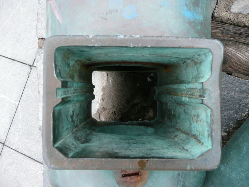

But what really got me interested was of the photo showing where the Breach Block would slide in from the side.
Dominick,
There is a number 9 stamped on the Muzzle, could this stand for 90mm, which is nearly 3 1/2 inches.

Thanks Rotunda, that photo makes the marks on the rear of the gun perfectly clear. I think you're right about the muzzle face mark representing the bore size and it is 90mm, but it's marked in centimeters measured from land to land.
Allen,
I don't doubt that N. 570. designates the foundry number, but I do highly doubt that 570 of this model rifled bronze breech loader were ever produced by any foundry in Spain at that time. A foundry number is the manufacturer's own internal control number, and the number stamped on an artillery piece doesn't necessarily represent the actual number in a series of a specific model that were produced by that foundry.
To me the date of 1896 is perhaps the most interesting thing about this bronze cannon; even a few years later at the time of the Spanish-American War, Spain's most current artillery was bought from other countries (Krupp and Hotchkiss). I wonder if they were experimenting with rifled bronze artillery at that late a date in some kind of desperate attempt at producing their own armament? At any rate it shows just how far Spain had slipped backwards as regards it being taken seriously as any kind of military power; remember that the venerable French 75mm was already in service by 1897.

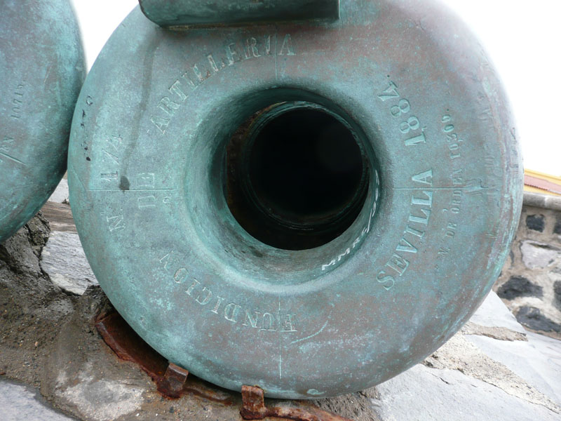

I think you will be interested in the date on the breech photo of the other cannon.

Yes I do find it interesting Rotunda, this is getting to be like a three stooges schtick and I'm playing the roles of two of them. :D
Ok, the date of 1884 is at least a little more reasonable for a bronze BLR cannon, but it's still astounding that they were casting a new one in 1896.
Now Rotunda, if you have another photo of a third cannon of this type on the island that happens to have the cypher of Philip II on it, please keep it under wraps, because if I see it I will probably flip my chair over backwards and hurt my noggin upon landing. :) ;D :D

That looks like an ammo hopper on top of the barrel to me .
But I have never seen such a thing .

 Interesting how they made it so there's no way to put the breech block in backwards. The part that the block slides into appears to be a separate casting inserted into the barrel.
 I'm thinking these have to be some kind of R&D pieces. With the relatively small diameter of the breech and thin sections on either side the only points keeping it from blowing off, the whole affair looks pretty flimsy.
