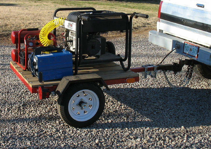

My set-up was similar to charles p , but I up-graded it some.  It is an 8K gasoline (noisy) Generator.  I could use a little larger one.   Power was off for more than a week one winter.  It saved our frozen and  refrigerated foods, and kept the family comfortable.  Connection to the house is a pigtail to the Breaker Box ~ via ~ an all weather box at the house, and inside a Generator Transfer Box that breaks from the pole to Generator at the flip of a switch .  Got tired of rolling it back and forth to the Shop, so set up this trailer rig plus some extras.  Now I can hook it to my ATV or truck and take it to the field for maintenance on  farm equipment, corrals, etc.
