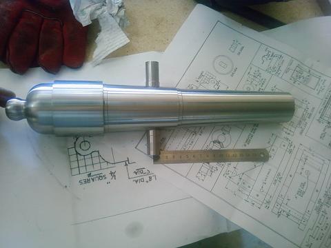

is a bad hobby when you have a friend, who when asked makes you things. Now what favour will I owe... and how much cash lol
New toy on the way. Hope to see it today
Due to my state laws has a max bore of 19mm and is just over 400mm long and 75mm round .... now if any one has an idea of a ball mould size :)
Owen.

19 mm = .748"; .748 * 39 / 40 = .729" (12 gauge.)  Lyman makes a .735" round ball mould which should be OK if you clean between shots.  A 1.5 ounce spherical sinker would be close, also.  Maybe you could use 12 gauge slugs?
Could you cheat on the 19mm with 19.49 mm?

I can go a max of 10g or 19.8mm ..... might take it to 20 and hope they dont messure it to closley
And yep it is the "before" didnt like the profile of the "after" barrel and i had the plans for the "after" and found it lost around 24" so i scaled it up to suit.

That is a nice looking cannon ! What kind of carriage will she get ?

I can go a max of 10g or 19.8mm ..... might take it to 20 and hope they don't measure it to closely
See what kind of round ball moulds you can find, then decide how much bigger to make it.

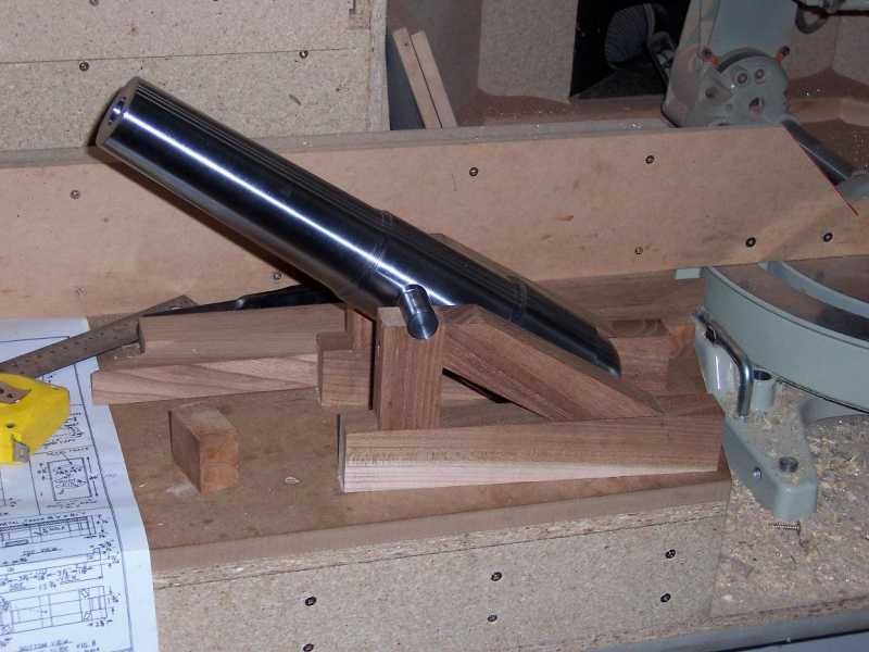

Got to see it today and help work on the carriage ... this part of the carriage is now complete now the slide and base in the next week or so :). The wood is english elm.

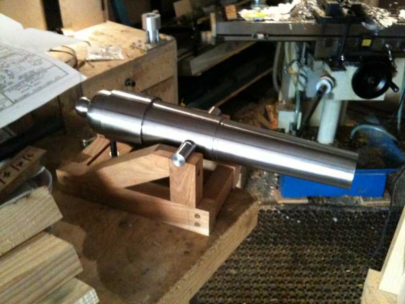

Nothing but rain for 2 weeks, our drought is over after 10 years. And going into Christmas time busy at work has slowed things down.
But found time to do a little bit of work on it.

Next step done. Need to make the metal fittings and plates to cover the screws up. Treat and polish the wood ..... sorry been told im not allowed to paint it .... Should get a base made in the next 2 weeks

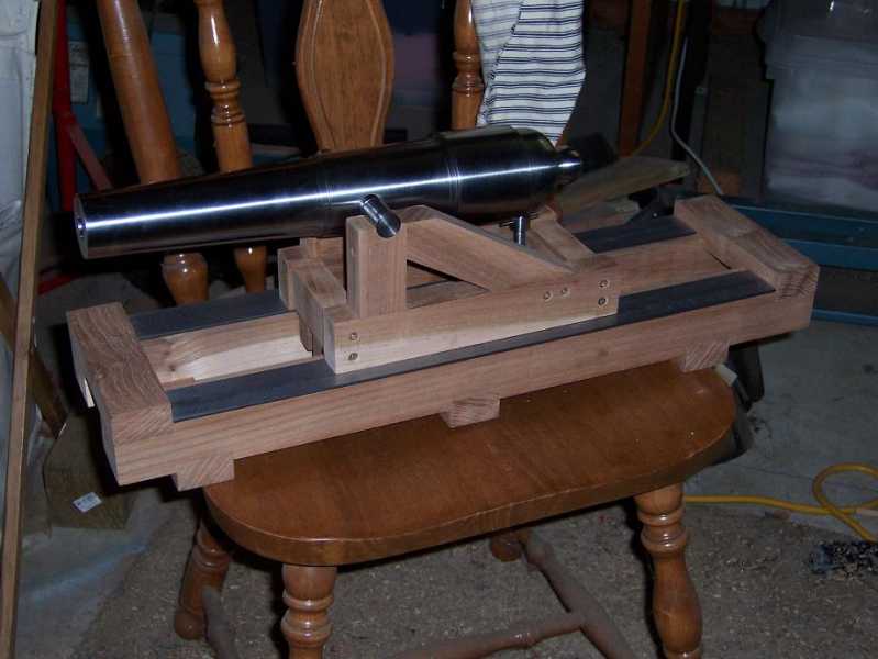

Nice sunny Sat morning with nothing else to do
