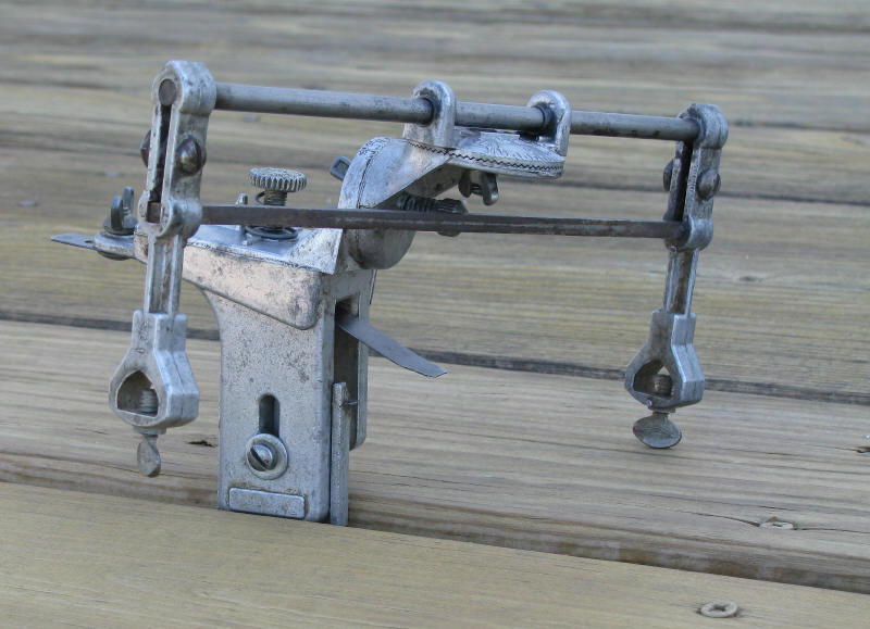

Drilling Man; when you mentioned 'Oregon',  I remember seeing the Oregon professional hand sharpener that looks awhole lot like my 50+ year old one, but with a few modifications.  I have no idea who made this one.  Dad may have gotten it at SEARS back in the early 60's.
  I use to have one exactly like the one in the pict, i may still have it IF i looked hard enough through my junk?  I also have one like it, except it has an electric motor to turn a stone to sharpen with, and a few other styles too.
  I just prefer to change chains in the field, and power sharp them when i have time...
