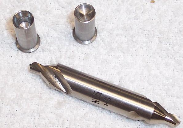

« Reply #6 on: October 03, 2010, 02:14:40 PM »
Here's what I did to my LEE .357 bullet seating plug for the SSP. Not something everyone will have in their toolbox but I used a #5 centering drill to recess the stock Lee plug. It's very similar to the Hornady plug that is included with their die set.

« Reply #7 on: October 03, 2010, 03:20:18 PM »
Thanks for all the good ideas.  I kinda took burntmuch's idea and ran with it since it was the first I got, and I was chompin at the bit to make some ammo.  I took my seater plug to my few houses away neighbor who is a retired tool maker, who has a backyard shop with enough machines to build anything.  He modified my plug in about 15 minutes and it works to perfection.  He charged me a quart of hash that I'll be making the end of this month, not a bad deal.  Guess I'll need to get another plug from Lee so I can also seat my regular 38/357's, but no big deal there.  Again, thanks for all you guys input.
