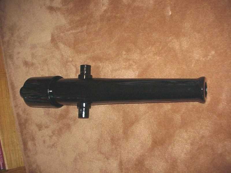

Have you seen these cannons--all wood.  www.jmelledge.com
