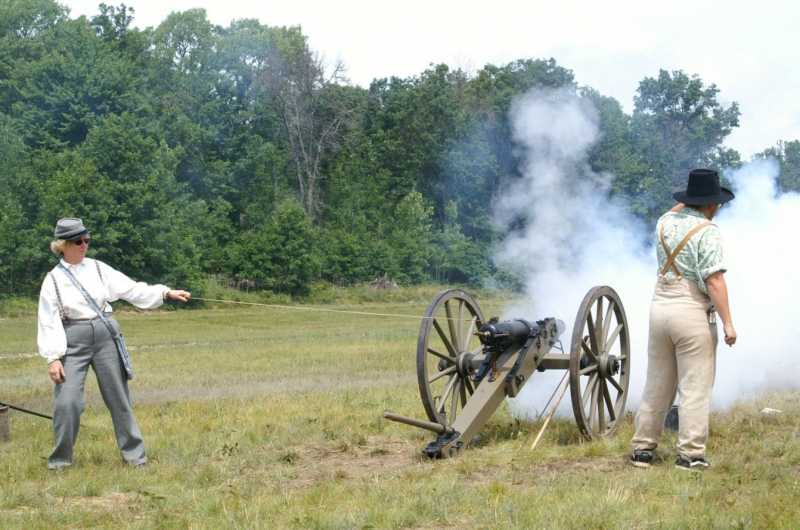

Offline Artilleryman
  • Posts: 1378
Re: Ellsworth gun
« Reply #13 on: September 04, 2010, 11:34:24 AM »
I'll ebter a picture for the artilleryman. His full scale 12lb. over looking the ellsworth gun.
I was looking for this photo.  Thanks for posting it.

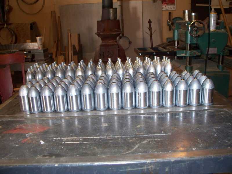

  • Posts: 1378
Re: Ellsworth gun
« Reply #14 on: September 04, 2010, 11:46:05 AM »
Projectiles that I am using in the Ellsworth.  The ones in the back have not been finished.
Re: Ellsworth gun
« Reply #15 on: September 04, 2010, 11:51:01 AM »
Norm,
Are those aluminum or zinc?
  • Posts: 1378
Re: Ellsworth gun
« Reply #16 on: September 04, 2010, 12:29:51 PM »
A casting, then turning of 17 oz. of zinc.

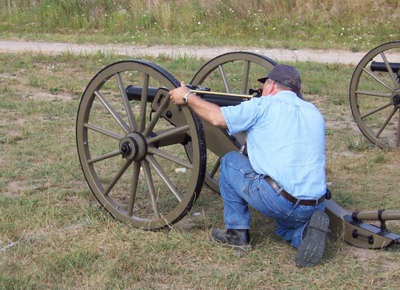

  • Posts: 1378
Re: Ellsworth gun
« Reply #21 on: September 05, 2010, 04:39:50 PM »
Photo giving an idea of how the tube sight is mounted.
Thanks Bob, I think I will give it a try.
Re: Ellsworth gun
« Reply #22 on: September 05, 2010, 04:53:19 PM »
Can you show us how this sight mounts on the gun.  Were these optical sights used on any other guns of the era?

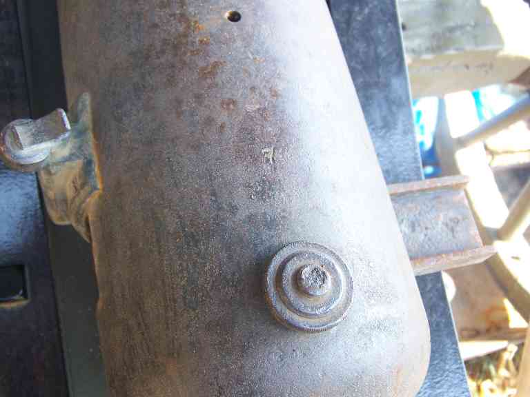

Offline guardsgunner
  • Posts: 421
Re: Ellsworth gun
« Reply #23 on: September 06, 2010, 01:46:48 PM »
DD,
  As far as I know, the Ellsworth is the only gun manufactured with a scope. There are some documented cases where telescopes were fixed to standard artillery pcs. The two pictures here are of a original in Mn. I only know of 2 original rear sight post's.
I think the scopes were probly Malcolm's.  I found an addvertisment stating "...telescopes for rifles and cannon.."

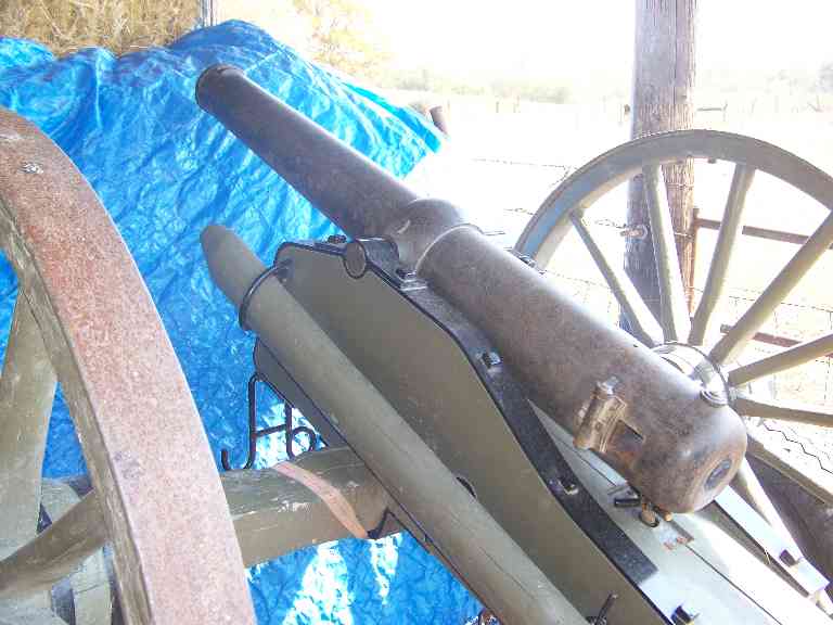

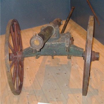

  • Posts: 421
Re: Ellsworth gun
« Reply #24 on: September 06, 2010, 01:55:38 PM »
Photo of the early version of the Ellsworth gun, a true John Brown cannon.
Re: Ellsworth gun
« Reply #25 on: September 06, 2010, 02:38:17 PM »
How did the scope mount on that?
All these questions....so I know where to go with next years postal shoot.
  • Posts: 421
Re: Ellsworth gun
« Reply #27 on: September 06, 2010, 03:27:53 PM »
The scope just lies in the two 1/2 round mounts on the ellsworth gun. The earlier gun's scope goes through the clamp on mount at the muzzle. therear mount is missing.
Re: Ellsworth gun
« Reply #28 on: September 06, 2010, 03:51:08 PM »
Is there only the one mount point.
Do you have any pictures of scope mount with people in the way so we can se how it mounts.
  • Posts: 1378
Re: Ellsworth gun
« Reply #29 on: September 06, 2010, 03:55:47 PM »
Front mount is on the trunnion rim base, and adjustable rear mount at the breech.  I have been looking through my photos and cannot find one that illustrates the mounting system.
