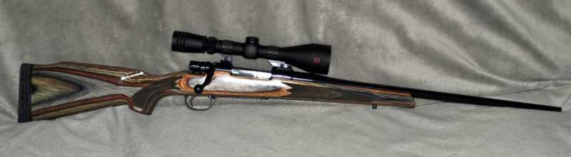

Well I finally got my Arisaka .308 build done, and took it to the range today.
My smith put a A&B 25 1/4 barrel on, also a Timmney trigger and saftey, that cleanly brakes at 2.5 lbs.. Bedded and free floated the barrel. I did the stock in several coats of tru-oil, and smoothed everything out with pulverized limestone and linseed oil.
My first and only load so far is 125 gr. Sierra Pro-hunter, behind it was 47 gr. of 4895. A couple of 3 shot groups came in right at an 1 inch. I have a sneaking suspicion that 168 SMK's would do well in it since it is a 1:10 twist. Anyway just wanted to post what I have been working on.

Nice looking rifle. With your 125 gr bullet drop back to 46 grs of IMR 4895 and see what it does. I shoot this load in a number of 308's with 125 Nosler ballistic tips and it will put them in the same hole. It kills deer like lightening struck them also.

That is a beauty; very nice metal and wood work.  That load must be pretty easy on both you and the rifle but those action are strong.  Looks a bit like the 98 excepting for the cocking piece.  Nice job.

Congrats on your 308 Arisaka.....looks nice.  I've had 4 or 5 A&B barrels installed in my military action sporters.  You should expect to get better than a 1" group.  If like mine, you should see improvement on your groups.  Seems like my groups showed improvement after maybe 40-50 rounds down barrel.
