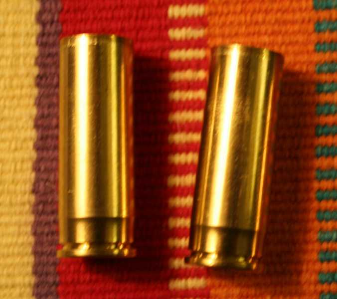

Well just picked up my LIL Buff and after all the initial fondling was done,went out and shot a few rounds through it to see if I got good or bad chamber,well count me in the bad chamber group,shooting a medium load 250 cast handload about 1000fps,my cases are balloned out 15 thousands,not the end of the world but discouraging none the less,............
Was wondering tacklebury how far out was your fired brass? mine resizes easy nuff, just hate to think I will have to trim more often,and lose brass life.....maybe wont be that bad, anyone out there think 15 thou. is to much??

My neck size is .475 on fired brass,My nosler manual says .480 for outside Dia. the ballooning is just up from the case head you can see it without having to measure it,I tried to slip one in my Ruger pistol and it went a little more than half way then stopped,you could see that it was going no more.
You would think that if its going to be a bad chamber it would be bad the whole length.
Alright everyone is this acceptable chamber dimensions? or did I get a lemon?
Love the little booger already,even with the birth defect........ :)

Ok a resized case using Dillon dies,and Starline brass measures .475 at the case head (I pushed a little to hard on the caliper wheel on my first measurement)no matter if it has been fired or not, the ballooning measures .485 that  puts me out 5 thou.  not 10  :-[ I never allowed for any expansion of the case at all on my first measurement and went off the case head dimension compared to the ballooning hence the 15 thou. DUH!!
 Well after looking like a complete moron,after all said and done my chamber is 5 thou.over, is that to much? I measured my Ruger spent case with the same ammo and it measures an even .480 all the way up to the case head and that measures .475
 It caught me funny because it was so noticeable when I extracted it from the gun,because its just a bulge and the goes back to .480 the rest of the way to the case mouth?

FWIW, I dont care for a chamber that is big enough to cause a visible 'bulge' when fire formed. We have SAAMI specs for reason. That said, there are ways to use out of spec. chamberd guns, but you will get reduced case life if you always resize.
Does the fired brass rechamber in different positions or only the way it came out?
Is it OK at the case mouth, just oversize from middle toward the base?
What does your gut tell you about this deal?

This was the problem I had once I had Wayne rechamber my 45LC CR to 454.  When I was loading for it as a 45 with only middle of the road load levels I saw no problem.  Once chambered to the higher pressure round - factory Hornady ammo did exactly what you are describing.  There was pronounced bulging at the join between the web of the case and the case head - right where you would expect a separation to eventually occur.  I haven't really seen this with any of my other handi rilfes, including my 500 Smith.  The 454 reamer did not even touch the back of the chamber at all.  I don't know why H&R would have such a problem with this particular caliber????? ??? ?????  Wayne was kind enough to offer to rechamber mine to a 50 Alaskan and rebore at a reduced price, even though the problem was obviously with H&R, not him.

Sorry bout the late response, but had company and lotta stuff going on. My first carbine was blowing out the lower portion of the brass abot 25 thousandths, so a little worse than yours.  15 thousandths is still pretty significant as federal spec. states it should be within 6 thousandths.  I'd probably look into the return for exchange process.  The second one I got was about 10 thousandths, but was in the middle and locked the fired brass in the chamber, so even though closer, it was still a problem.

One more thought on this.  I've discussed it with a couple smiths and they stated that the only way this should be happening in a proper chamber cutting machine would be if 1) the oiler isn't maintained and heat makes the tool bind up some, 2) chips of metal are getting caught in the end of the boring tool and cause it to wobble and 3) the tools aren't kept sharp or are too soft of a material.  I think Tim stated in a post yesterday that part of the extra barrel shortage was that H&R is shutting down one production facility to move or replace it or something.  This cold be part of what is driving it.  I do get some expansion on my .45-70 also, but it's not as severe.  These are the only two I own, so all I can go by.  It's probably on many barrels, but to varying degrees.  8(

Here is what mine was doing.  Remember these are just factory loads - and not Buffalo Bore, either.  Wayne thought this was not necessarily a dangerous condition, but agreed that it would be mighty hard on brass.  I can't imagine what a hot handload would look like!

 Thats much more pronounced than mine are,but yours look like they measure the same from where it starts to the case mouth,where as mine is like a bulge?
Thats how I would think an oversized chamber should look, What does it measure at the start of the expansion?
