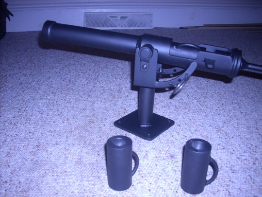

Mike and Tracy,
If you go with the mug style breech, you wouldn't have to deal the the gas leakage issue.  I used this set up several times and it's no different than a black powder revolver as far as the seal is concerned.   A cross pin perhaps for retension?  I vote for the longer barrel but the Howitzer is a certainly a close second.  Also, I been looking at building one of those dissappearing guns for a long time.  Some of those were counterweight driven and it would be interesting to see how it would react in a small cannon.  It's a lot of work though, even with adding just a few of the details.  If I can find the time.  Dom
