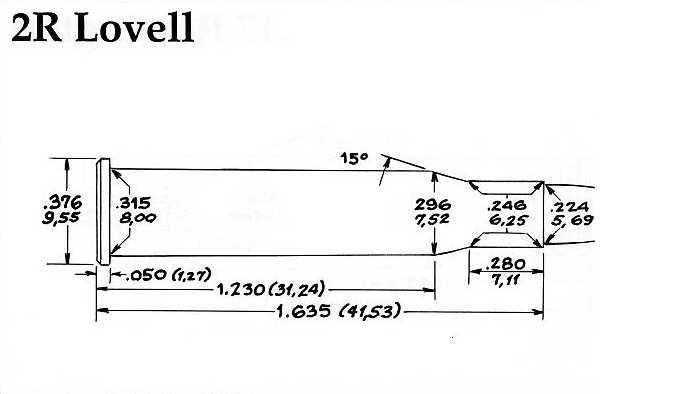

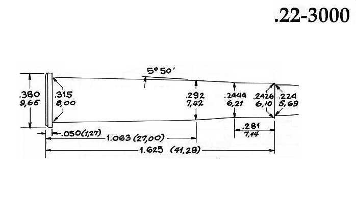

I recall a 270 Wren, but at the moment can't recall if it was in fact a BR or a 308W parent case. Any memories?
The parent case for a 270 Ren is a 22 Hornet. It was designed specifically for shooting IHMSA Field Pistol.
I would neck up no question because you can start with Lapua brass and specify a no turn neck to keep it simple. If you neck down you're stuck with Remington. Not bad brass but not Lapua. Personally I would go with the 6.5mmBR. It's a solid deer round and a killer paper puncher.
Funny how many conversations from a lot of different sources come back to 264 caliber...to make 6.5mm BR Rem brass, run a Lapua 6mm BR Rem case thru a 6.5mm BR Rem die? I do not want to mess with necks either.
