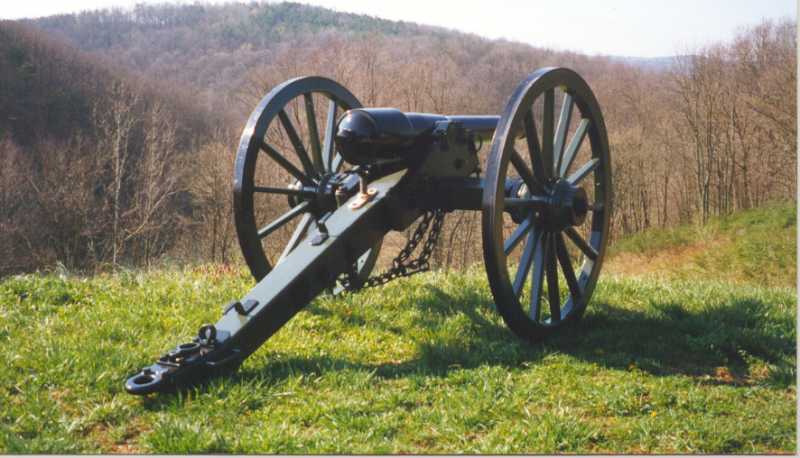

Here are some pics.  The Owner looked to be having family over so I just snapped some pics from my car.
Re: considering purchasing cannon, need help
« Reply #5 on: June 12, 2010, 01:06:38 PM »
The carriage looks pretty good; hopefully it is not pine or some other soft wood.  The barrel looks like a smaller piece of tubing with a shrunk on reinforce over the powder chamber.  Not exactly a Parrott profile since there is no taper but assuming the dimensions are appropriate, it should be safe to shoot.

To my eye the barrel looks suspiciously like a piece of pipe screwed into a larger chamber part.  The barrel does not look like one solid machined unit.  You need to know beyond any doubt what that barrel is made of.
I believe Southern yellow pine was used for carriage material, but hardwood is much preferred for the strength.  If any part of this gun has any value it is the carriage, if it is sound.
« Reply #9 on: June 12, 2010, 03:09:30 PM »
Whats strange is that someone paid fairly good attention to detail with the carriage
as to detail it almost looks like you could drop a correct size Civil War tube on it
and have a good looking set up, the wheels and axle probably came from a farm
wagon , where things really went south is the actual building of the cannon....
another concern is how the trunnions are attached & what the welds look like.

Ok, met with the Owner this morning and took some more detailed photos.  The barrel is definitelly some type of steel.  The bore is rusty as I shined a light down it.  The bore diameter is 2.75", the wall thickness at the muzzel is 11/16" and the ovaral diameter at the muszzel is 4 3/16"  and the circumference is about 13 1/8".  The smaller diameter part of the barrel is 56" long and the thicker part of the barrel is 16 1/2" long with a circumference of 27 3/8".  I can not tell how the two pieces are attached.   the ovarall width from wheel to wheel is 61".  I hope this is some useful information.  I do need to make a decision on the cannon, any ideas on if it is a good purchase and what a fair price would be?

My frank opinion...run away from that!
Bore needs some very heavy work. It has some serious neglect.  Doesn't look like pipe, could be heavy walled tubing.  If it's seamless tubing  fine, but if it's welded seam, then it's scary.
This by it self rules this gun out in my book for any serious consideration for any purpose.
Tell us about this gun!!
« Reply #13 on: June 13, 2010, 07:49:37 AM »
After seeing the bore on this I would save your money and walk away!
the bore is pitted and has scale rust along the length that can be seen,
you would be better served looking at some of our sponsors cannon
for something reliable that will not be a money pit.
Other deficiencies I note from photo's :
Wheels more than likely are loose there is a lot of filler on these wheels
which means someone is trying to hide something not just pretty it up.
the pine trail may hold up but I can show you photo's of a correct Reproduction C.W. cannon
that had a field load fired with ball with a broken oak trail. also if you look at the one photo
showing the front of the trail below the barrel I again see putty - not a good sign.
trunnions look to be made well trunnion irons show gaps between iron and wood again either
wood strips have been added or there is more putty involved.
you will be buying a project that would be better serve as a lawn ornament. the barrel should be
filled with concrete. just my opinion and you know what opinions are worth.
Allen <><

I have to agree, say "Thanks for your time, but I'll pass on it."  That bore is downright frightening.  Not only the rust, but it looks uneven - which might be an illusion from the flash.  MAYBE if you were to hone it clean and even, the install a heavy sleeve it could work.   But by the time you did all that, you could buy a new, solid tube that you wouldn't have to worry about.

I can comment on the carriage and leave the barrel to the experts. There is no doubt that wood filler is on the carriage. So no doubt there are weak spots in the build. There is also some pretty dry wood on the wheels that would not with stand much pounding from firing. As a project the metal piece might be good to build a different carriage. (Not commenting on the barrel there.)
Best advice I saw, "Thanks" and run. Second best, fill it in with concrete and use it as a lawn ornament.

The barrel looks like it was made from an existing machinery part.  The transition from the large diameter to small has a robotic type mig weld.  It's welded while being rotated.  It may have been a large roller shaft at one time that was drilled.  I haven't seen any tubing with that rough a bore.  I've seen drilled bores that rough. [Been there, Done that].  Even hot formed seamless tubing, which has the roughest ID's of tubing that size does not normally have a finish with ripples along it's length.  Hot formed seamless usually has either an egg shaped bore or one with flat spots that run along the length.  It's made by piercing a hardened bar through a piece or solid round.
