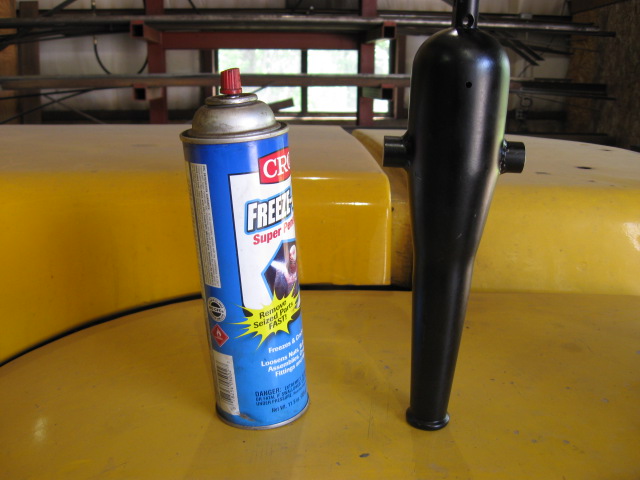

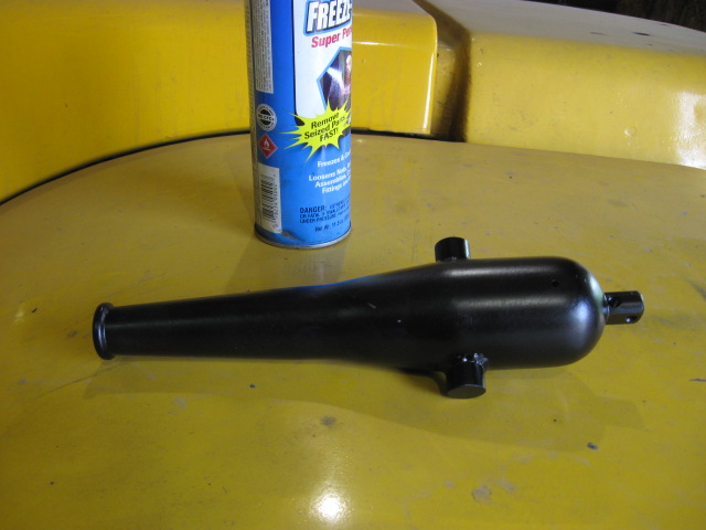

Hi , I made this from a set of prints for a .375 bore , doubled all dimensions and everything worked except the proportions look wrong . Is it just me ? Comments wanted . Armorer77
Thanks guys .

If you are using the drawing I think you are using, here is the numbers you should have used.
Lengths
oal   5 1/2"    5.5x2=11"
Muzzle swell 1/8 .125x2=.25"
first taper   2 9/32"*   2.28125x2=4.5625""
second taper   1  3/16"   1.1875x2=2.375" have got
cylinder    15/16"   0.9375x2=1.875"
cascabel     9/16"    0.5625x2=1.125"
*Keep in mind the first taper is 1/8 shorter in the drawing than the length given, 1/8" inch doubled to 1/4  to allow for muzzle swell.
diameters
Muzzle swell   19/32"   0.59375x2=   1.1875"
MS at 1st taper    1/2"   0.5x2=1""
1st at 2nd taper    3/4"   0.75x2=1.5
2nd at cylinder   1  3/32"   1.09375x2=   2.1875""
cyl at cascable   1  3/32"   1.09375x2=   2.1875
Is that what you got?

« Reply #5 on: May 24, 2010, 07:16:57 PM »
This is indeed the print I got from you . The only number I changed is the breech Diameter . I increased that from 2.187" to 2.25" . Other than that , all numbers check .
Re: 9" Dahlgren in .75 cal
« Reply #6 on: May 24, 2010, 08:17:13 PM »
If you increased some svelte piece of female eye candy's waist by almost 3% she would look positively fat.  With a gun that small it makes a big difference.
I know why you made the cylinder 2.25.  What you need to do is  multiply all measurement by 2.057
Here are the number you should have used.
Lengths
oal       11.314
muzzle swell 0.257
first taper    4.693
second taper 2.443
cylinder     1.928
cascabel     1.157
diameters
muzzle swell        1.2213
start of 1st taper        1.0285
1st to 2nd taper        1.5428
2nd to cylinder       2.2498
cyl to cascable       2.2498
Try these numbers and send the barrel to me and I well you if they are right.  I am retired and won't be able to afford to send the barrel back, honest.  ;D

Comparing the model barrel to the middle pic above, it seems like the transition from the cylinder is taking place too far forward, about the center of the trunnions, instead of a whole trunnion diameter behind the trunnions.

Your model has a fat waist.  Your double measurement for the cylinder should be 2.1875, but you made it 2.25 for the one caliber wall thickness safety rule.. At this  size that .0625 is a huge difference.
Use the new numbers. When you upscale you have upscale all of the them.   Your multiple for all measurements is 2.057.  If you multiply all measurements by that number all your proportions will be correct.  Try it one time, to humor me, I think you will be pleased.

Your first blending is along the trunions . On Mikes picture the blend is foward of the trunion .  That gives it a nose heavy look .

Ed,  The diagram in reply #16 shows the muzzle flare being very short and I don't think this is how the original barrel is.  I think the bottom diagram in reply #19 is the correct muzzle flare.
  I noticed with the few I built that the muzzle flare makes a difference in overall appearance.  Very nice job on it.  :) Dom

I used to set the compound at 10 degrees when cutting the flare.  The diagram looks like it's about 30 degrees.

Green's finished barrel is 5 1/2 inch long.  Green's flare starts 1/8" from the muzzle at the 1/2 inch starting diameter of the first taper, flaring out to 19/32" at the muzzle.
That translates in Ed's upscale at 2.057x to:  flare starts .257" from the muzzle at the 1.028 inch starting diameter of the first taper, flaring out to 1.221" at the muzzle.
