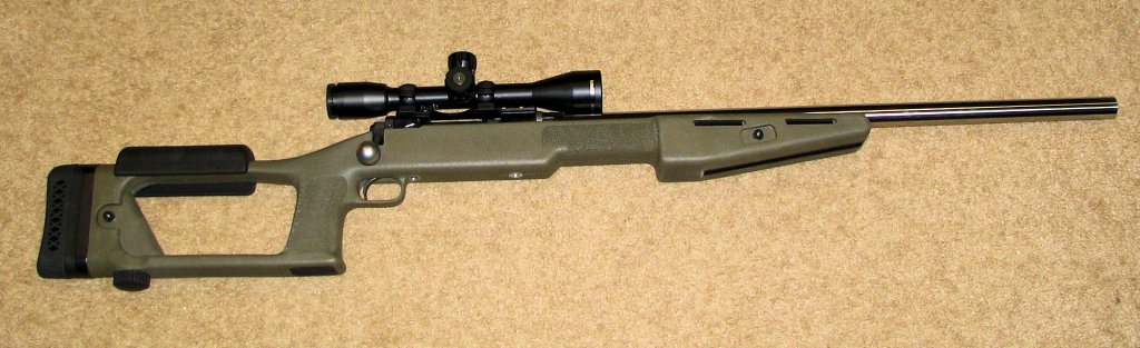

I have a gray with black spider webbing Medalist on a Remington 700 short action (the same color as the picture above) and I have the Chaote on a Stevens 200 short action with a Shilen select match grade barrel. I like them both. The Medalist is heavy and the Chaote is even heavier. I think the styling on the Bell & Carlson is better, but accuracy wise, you can take your pick.
Here is a picture of the Chaote stock.
