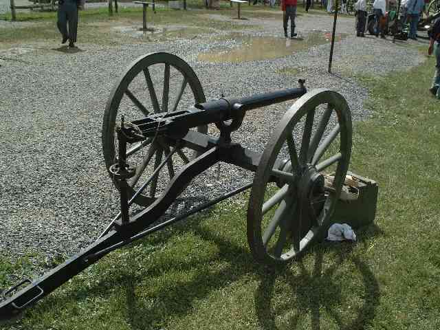

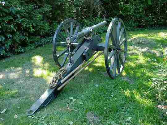

I was curious if the Williams rifle was really a Williams gun as none of them were rifled. Thought maybe I had missed another. The only refernce to them being rifled comes from the commander of the 66 Ill who claims Lt. Holt's williams guns were rifled.
What they really looked like.
http://freepages.military.rootsweb.ancestry.com/~us14thkyinfantry/photo/reunion.html
and the one my buddy built. Some parts had to be scaled up to meet NSSA requirements.
