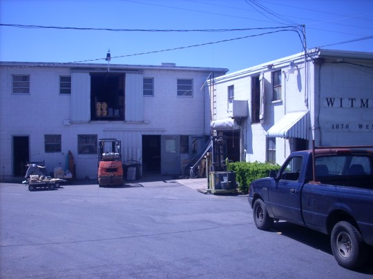

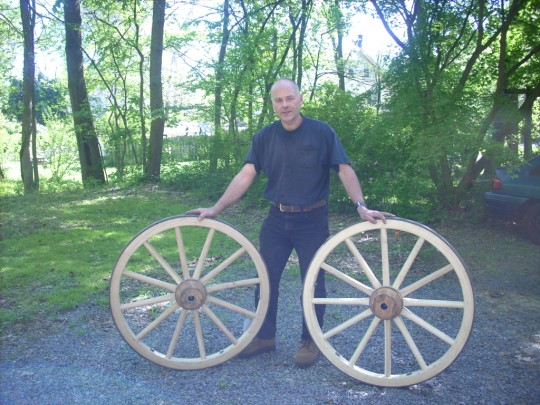

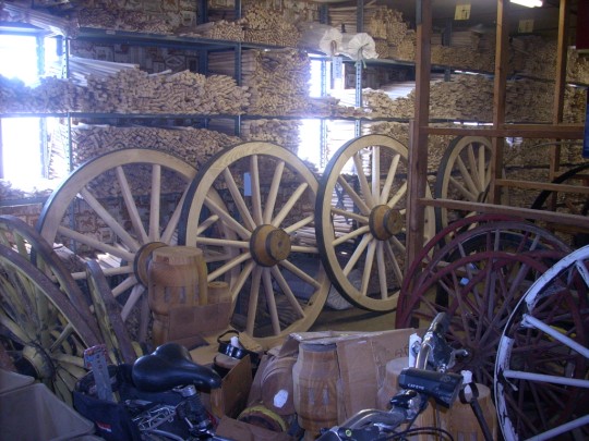

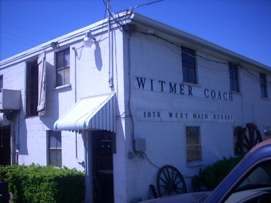

I picked up the wheels yesterday for a cannon I'm restoring.  The shop that built these is about a 40 minute drive fom me.  The name is Witmer Coach Shop and it appears that they are well known in the cannon building industry. They have in stock several cannon wheels along with the capability of making custom wheels.  I took a few pictures while there.  I guess I should have taken some more.  The four new wheels in the third photo are 57" diameter Civil War No. 1 carriage wheels.   Needless to say I'm very pleased with the product.  The wheels I have are 38" Pack Carriage.  Dom

Great pics Dom, a few more from inside that shop would be good, and the cannon you are restoring too.

Dom,
 Thanks for the photos. It's nice to see where stuff comes from. Since, I'm on the other side... I have a set of Whitmer's 20's sitting underneath your Parrott tube. Which, by the way I have not finished as I have a few too many "Intoodeep" projects going on.

   yea they make great wheels i have  a set on my cannon and going to buy another set of 42's for a limber

Guys, is there contact info available for these guys? What kind of price would I be looking at? I have a couple of leads on wheels locally but I will have to do some work on them and they are still 350.00 for the pair......

Thats cool a wagon/cannon wheel maker 40 miles away .
I'll look them up on the net . I was looking at Hansens Wheels last week.
Witmer Coach Shop
1070 West Main St.
New Holland, Pa 17557
PH # 717-656-3411

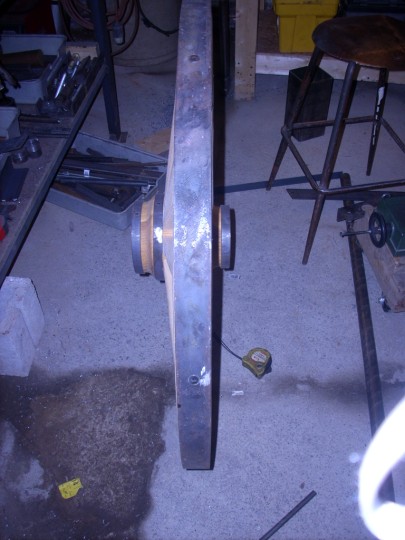

It's hard to tell in the photo of the wheels you bought, are they dished?

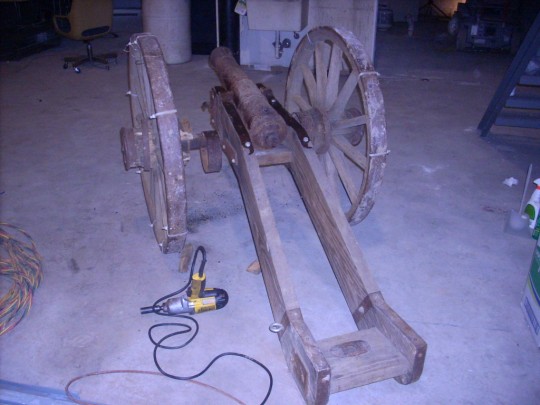

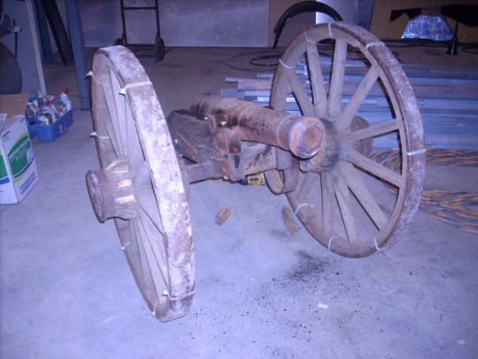

  Next trip up there I'll take more photos.  The wheels are for a Revolutionary war style cannon I'm rebuilding  .  Here's a few before photos I took earlier this year.  The barrel is cast iron and I sent it out to have bored and a sleeve installed.  I made the sleeve but I don't have the large boring equipment to do the work.  The cannon owner owns a cabinet shop so he will make the carriage pieces to my specs.  I will make it come together and do the iron work.  I'll upload more photos as the work progresses.  Dom

Kabar,  The wheels are dished.  Here's an edge view.
Interesting.  The rim appears to be perpendicular to the axis of the wheel which will put it at an angle (not parallel) to the ground when properly mounted.
Re: My visit to a cannon wheel maker
« Reply #12 on: May 08, 2010, 10:01:20 PM »
"The rim appears to be perpendicular to the axis of the wheel which will put it at an angle (not parallel) to the ground when properly mounted."
That is, unless it was intended to be used on a straight axle arm.

I'm using it on a straight axle.  I thought the wooden wheels were all built this way anyhow.  Otherwise the tires would have to be bent sideways to conform to the fellows.  That would be tough to make a proper fit.

  Your  right Dom. All wheels are a few degrees to the ground ,running hard on outer edge to keep true on straight move . This even applies to trailers made today. Thus the iron tire hoops are square to the edges and axle line of the wheel .

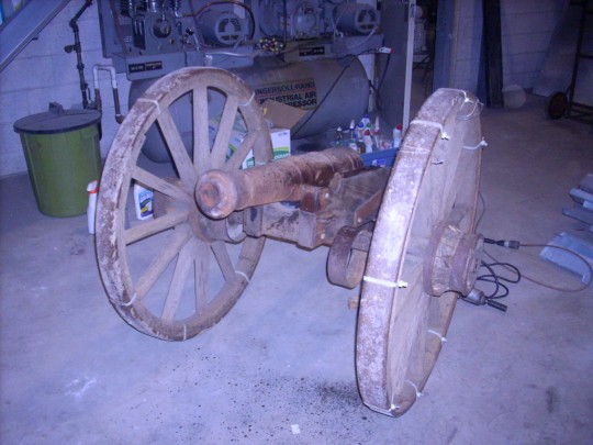

Tom,  The cannon is a repro built about 35 years ago.  The wheels are from a farm wagon.  The owner had someone cast the barrel for him and he buillt his own carriage.

 I see . Looks like would be much left of old except barrel , can probably resale old wheels to decor market after you remove ty-raps.
   Got the tour many years ago at Witmers  great place was surprised they still looped and hot shrunk their wheels ,had inside forge ,and then cold shrunk. What a machine ! I think the man to talk to is Earl  and phone is 717-656 8877 or 3411. I know they'll send you great catalogs on wheels and carriage (buggy) parts for couple bucks.

Earl is who I dealt with.  The old wheels are disintegrating every time I move the carriage.  They're pretty much junk.  The hubs are slip in several places and pieces are missing.

Boom,  I understand what you're saying about the axle taper.  This cambers the wheel out at the top and the taper keeps the wheel tight to the axle.  I don't understand what you are saying about the wheel itself.  Do you have a drawing?
