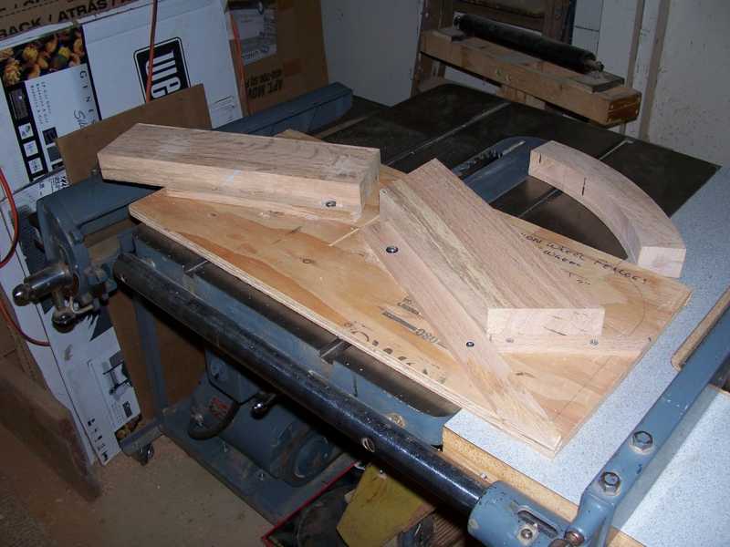

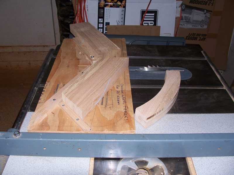

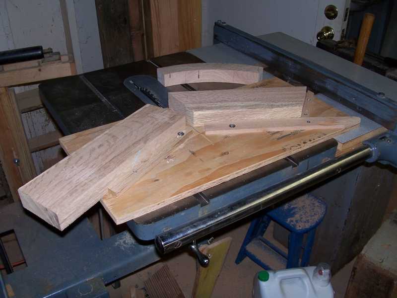

Well gentlemen, you want wheels?  Lets get started.  I have begun a 1/2 scale No. 1 field carriage.  I wanted to complete the project and offer a photo build, but since this thread has started maybe we can all learn something.  I started with the wheels.  Not finished, but started.   The spokes are where I paused, or maybe the word is hiatus.  Anyway here is what I have done so far.
The first three shots are of the jig I made to cut the 25.7 deg. angles on the felloes.
Getting late so I'll continue tomorrow.      Ron

Should have added that on the jig, the stocks first angle is cut on the left side of the jig.  Then pushed over to the right side against a stop, where the second angle is cut and at the correct length.
Max gives a good pix of the spoke.  My big problem is getting the felloe tenon cut at the 6 deg. off set.
