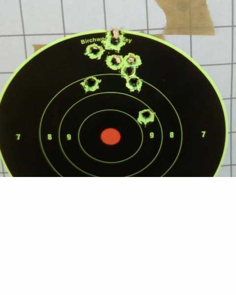

I was real pleased with the results using AA8700 and the 175-grain Remington C-L at the range.  The old rifle is performing good on handloads but I wanted to generate some more brass and what better way than to shoot some Brand X factory ammunition I bought at good price for the brass a few years ago.  If I mentioned the brand name I would be beat, oiled and feathered.  This would be another chance to prove them right while I had the Chrony setup.
As I mentioned before this rifle does not like factory ammunition and it shoots patterns, not groups.  When I use the Chrony I set the target up at 50-yards to lessen the chance of hitting Chrony with a round.  I am sure the guy at the next bench would not want to get hit with chunks of flying Chrony.  I was shooting a 160-grain pointed bullet and was not very impressed with the velocity.  It averaged out at 2847 fps from a 24-inch barrel.  I was a little more impressed when I ran the numbers comparing it with a very effective 150-grain load out of my .270 Winchester.  When I strolled down and checked the target during a ceasefire I got a little surprise.  I do not have a published velocity for this ammunition but other brands are about 100 fps more than what I got.

I blame the 100-yard target on age, trembling hands, and the gusty wind.  I confirmed the gusty wind from a printout at a nearby fire weather station.
The hole in the nine ring was a six o’clock hold.    Seeing where that one hit, I adjusted the scope and fired the group.  Corrected average velocity was 3007 fps.  I add 20 fps because the Chrony is set 15 feet from the muzzle.  I used a ballistics program to come up with this close wag.
Setting up the Chrony for me is not fun, I am very careful because I do not want to blow it away.  I do it to gather data.  Once I set it up I wanted to take full advantage of it.  Over twenty years ago I loaded up a hundred rounds using the Speer 160-grain Mag-T bullet and surplus 4831.  I used the mid load in the now ban Speer #7 Manual.    At the time I was impressed with the accuracy of the bullet, but latter switched to 160-grain Splitzer because the Mag-T fly’s like a brick, dropping rapidly, and shedding velocity.  The old load generated 3000 fps.  The manual shows a velocity of 3006 fps.  It should be noted my more current Speer #12 shows a reduction in the load using H4831.
I fired six rounds of the above load; the extreme spread in velocity was 6 fps.  Regrettable I fired these on two different targets.  I did not take a picture because of the two targets, but the bullets on each were touching.
