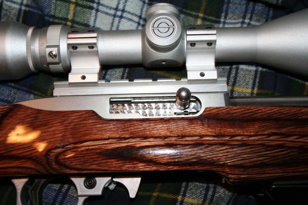

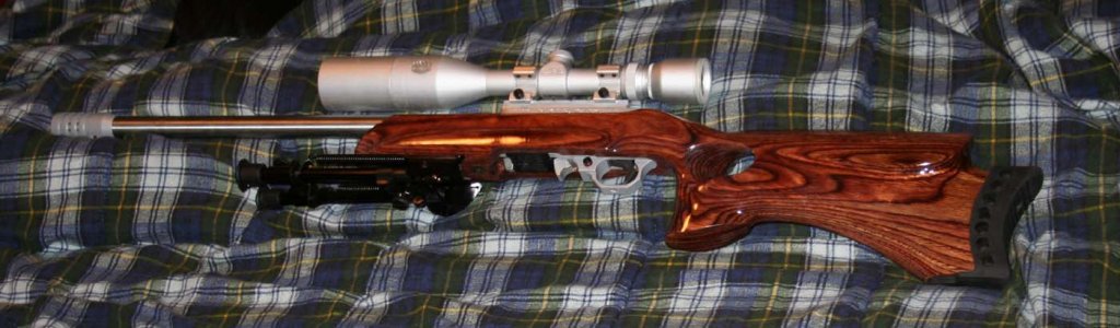

When I built this 10/22 I personally didn't like the Hogue OM I had bought for it, so I replaced it with a Boyds.   I just didn't like the gushy feeling of the stock, or how it got filthy dirty so easy (I swear, just looking at it made it dirty).
As said, watch out building up a 10/22 unless you own a bank.   I did good by shopping parts when I built this one full of goodies years ago, but it still was alot of money for what it is.   I didn't like it though so it has only been shot less than 50 rounds and just sits in the safe.   Has Volquartzen guts, the Ross/Burchell 10/22 stocks have been long discontinued by Boyds as is the Whiteface Mountain Match barrel I bought for it direct from the man.
