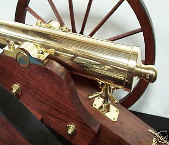

I know it's probably not authentic, but I would go with cherry.  Cherry darkens quickly, so you get a natural aged look in a short period of time.  Quarter sawn white oak is second choice.
     xo18thfa,  We like cherry too and walnut and mahogany, they are so easy to work and look very nice too, but our favorite is still white oak.  Below are a few snap shots from the pile of wood that will go into one of the three Brooke rifles we are currently making for customers around the country.  One customer wanted fancy wood, so we indicated that was possible as long as it was white oak. He's getting the nicest quarter sawn white oak that we have worked in a long, long time.
There was a guy that was selling his scale model (different sizes, this one had a 16'' barrel) cannons on an e-auction site, and on some of his pieces the carriages and wheels were made of cherry; it is definitely a good looking wood.
