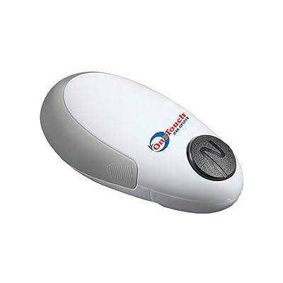

 Dang.... Soup cans do fit. Me and my family eat it all the time too. I tried it for fit before, but I think it was with one that had the crimped on caps at both ends instead of one that only had a rim on the top. Steel cans should hold up much better than aluminum.
 I'll still have to remove the top rim. Has anyone tried one of those can openers that cut through the rim around the outside diameter? Do they work okay?

The one we have works great.  And it doesn't leave the sharp edge either.  I bought it for my wife, but I use it all the time now too.

We have one of those.
It also has the advantage of being battery powered, so it can be used outdoors or pretty much anywhere.

Victor,
We've got one of the electric kind, but I always use a manual one sold by "The Pampered Chef" that my wife picked up at one those house party demos where they sell this stuff, and it works great. It's easy to tell when the can has been cut all the way around, and it has a small pincer on it that you then put on the rim of the can to pop off the lid. This one also dulls the edge of the can where it was cut. I know this sounds kind of weird, but I enjoy using this thing, so when she's cooking or baking and needs some cans opened I'll volunteer my services, and she thinks I'm doing it to help her out, which (BTW) is an easy way to score some points.
