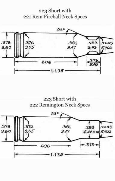

Thanks for the valuable and detailed input. One of the reasons I throw these things out for comment and review, is I know there are folks that have been there and done that on GBO.
Based on your and other input about minimal neck length, the next chambering will use a 222 Rem neck spec., here are both current and future case drawings.
As always, I appreciate your input, it will help make the project a success.
Contrary to the above description of 223 Short Part 2, through more recent research on my part, we by chance almost hit the optimal length from base to start of shoulder (Case length x 0.7072). I originally specified the case to be 1.125" max. Jed made up the first batch of dummies for the reamer design at 1.135" max.
In a later version of the 223 Short, after we test the current design thoroughly, I will make what you would call a "Bench Rest" version. It will have a 30 degree shoulder angle, that starts at .803" from the base of the case, and have a .008" or .011" case taper.
These three attributes are based on the common Remington and PPC benchrest designs, a smart place to start I think. Case diameter, and length of neck and shoulder do not seem to be critical in the short BR cartridges. I will accept whatever results from the three BR attributes specified for the 223 Short. I know if I had the software, I could know what the shoulder and neck lengths will be ahead of time. Shane, can you run it up the software flagpole when you get a chance?
I do not know if the taper should be proportional or absolute compared to the popular BR cases. Absolute is 0.011", proportional based on case length would be .008" taper.
Another similar round with less case capacity is the 5.7x28 FN, the ballistic equivalent of the 22 Hornet (150yds), which is 75 yards short of our design goal of 225yds. The differences are it has a case length of 1.138", zero taper, and a 35 degree shoulder that starts at 0.9114" from the base. It is optimized for semi-auto use, we plan on bolt-action and single-shot use.
Thanks for everyone's continued interest, I think Spring will be seminal for the 223 Short project thanks to Jed, Larry and Shane.
Cartridge drawings are derived from those available on Steve's Pages. One of these days I will be able to make a donation to GBO and Steve as well.
http://www.stevespages.com/page8d.htm

Hi Brian, & Crew,
 With the dims. given in the last dwg., the neck length, would end up @ .235". This combination, should help to reach your goal. Has anyone decided if ID reaming, or neck turning, will give the best results, balanced with ease
of processing?
 I would like to wish all of you, a safe, holiday season.
Bob

Hi Brian, & Crew,
of processing?
Bob
Thanks Chip (<-- I am assuming that): Everything helps. We are sticking with the original chambering, except on mine, Larry will size the chamber neck for the 221 FB case OD thickness.

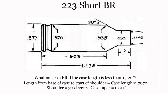

I have an observation about the accuracy and performance Shane saw last season. As the round unexpectedly behaves more like a 221 FB than the 218 Bee and 22 Rem Jet that it was designed to replace, I think the case design may have something to do with it, as well as the L'il Gun powder. Some of you know that I have spent a lot of time looking at the Bench Rest cartridges and came to the conclusion that they are of a particular length 1.52" or so, and they have a 30 degree shoulder, and the shoulder starts at 1.075" from the base of the case, and they use small rifle primers and flash holes.
By chance, the Shorts shoulder starts at .806" from the base, if BR specs were applied, than the shoulder would start at .803" from the base. So just by chance we hit one of the BR specs. Also, the folks that know BR cartridges (www.6mmbr.com) assign the small rifle primer and flash hole as major contributor to the accuracy of the 6mm PPC, but they do not know exactly how or why.

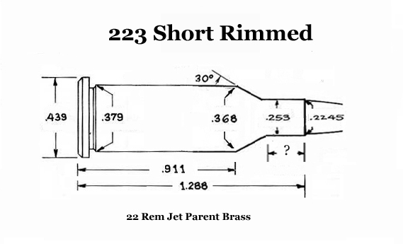

Dumb question, could .357 mag cases be used to make a rimmed version for a Martini rifle?  I think this would be a killer round for these old guns...
Tony
Tony
I have been thinking of using the 22 Rem Jet case, already a 357 mag necked down to 22cal. They are cheap from Privi. I would put a 30 degree shoulder on it that starts 0.911" from the base.
I'd really like to see how this works out.  I'm really looking forward to getting the Martini fixed and I'm holding off until I can afford to install a new barrel at the same time...
Tony

Had an email exchange with another GBO member about location of shoulder, neck lengths and shoulder angle. We will do a 223 Short v2 that uses a 40 deg shoulder, leaving the neck length a little longer. It seems that shoulder angle focuses the charge and 40 deg is pretty much the perfect focus. Also, reducing charges for the slightly reduced case capacity if the shoulder is changed, should result in more complete burning inside the case, less barrel combustion, maybe 3% increase in velocity.
I would like to do a rimmed version too, so applying the same specs to 22 Rem Jet cases would be pretty much ideal. Would be a good candidate for a 22 Hornet Handi rechamber, using slightly heavier bullets than the Hornet seated out a little further to take up the .103" freebore difference with the Hornet. Should be interesting.

Brian Note: I had to rework the Bolt Thrust Calculations here to make sure they were correct, they were not.
Nothing yet about light bullet testing.
Just had a chat buddy (Torp) ask me tonight if we could re-chamber a Martini 22LR for 223 Short.
I thought about it, and then read about it, then converted 303 Savage pressures (The Martini uses Brit 303 bolt and I assume outside chamber diameters) to PSI and came up with 37,000 PSI. The Martini case head is 0.166 Square Inches, and the 223 Short case head is 0.112 Square Inches and 55,000psi.
223 Short BT = 55,000 x ((.378 x .378) x 0.7852) = 7858 ft/lb
303 Brit BT = 49,000 x ((.460 x .460) x 0.7852) = 8141 ft/lb
The 223 Short BT is 96% of the 303 Brit.
Web article says typical SAAMI proofing barrels have to withstand  33% -  44% over pressure. http://kwk.us/pressures.html
If so, the Martini can be re-chambered to 223 S using the same action.
This also verifes Tony's Cadet that was modified for 222 Rimmed successfully is safe.
Yes Dorothy, there is a re-chambering Good Fairy!
