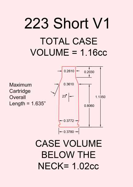

This is the 223 Short V1 Final Design from which we are getting a production chamber reamer made. Also getting a die reamer made if we need that too. I will send the  chamber reamer to Larry so he can chamber the slow twist barrel (1:12 I think) he has had hanging about for the best part of a year.
I will match the barrel up with a Steven's rifle, also part of our "poor man's" design goals. At some stage after we complete development, I will get a Savage short action with Accutrigger and Accustock, just to see what we can squeeze out of the Short in the 35g to 46g bullet range. I am counting on the Short not to be a barrel burner as we use only as much powder as a 22 Hornet.
As we made all our brass to date from different head stamps, the outside neck diameter ranges from .256 using 221 FB brass to .258, .2605 to .261 using other types. We had to settle on the largest neck OD to meet our design goal of catering to those folks who pick up range brass or use mil. surp. and want to make 223 Short cases themselves - yep, this is a poor man's wildcat, that is for sure.
Also, once the form & trim die is cut down and reamed, as soon as I get my first batch of 223 Shorts completed, I will get 100 x 22 Rem Jet cases from PRVI (they are cheap and a lot easier to form than 357 Mag cases) and use the same dies to form the 223 Short Rimmed cases. It'll look like the 218 Bee but dimensions will be quite different. We will have to get another reamer made to account for the rim recess, so my thinking is that will come in the new year.
I already have our first volunteer tester lined up for the rimmed version, in a converted Martini that was re-barelled for the 22 LR way back when. They kept the same action as the 303 British it was originally designed for. A few posts back you can see the bolt face thrust calculations we used to determine that the 22 Short Rimmed will be safe in the old rifle.
I appreciate your continued interest in the project, and look forward to being able to post the final development figures, and then continue the thread with folks that want to try the short themselves and want to report back to the thread. The beauty of trying the short using a barrel blank chambered to size, is that if you don't like it, your barrel can be rechambered to a 221 FB or 222 Rem or 223 Rem etc. This makes it a very safe wildcat to explore.
We will also get a number of extra form and trim dies modified for the Short if folks don't want to modify their own dies. The reamers will be available for rent thru GBO H&R Forum, and I may send a couple to Clymer's so they have them on hand as well.
I have got over any feelings of proprietorship in the design. I feel honored that after I designed it, other GBO members took up the challenge to get it well and truly prototyped and tested. It is a testament to the people you find at GBO.
We have had a good time developing this on a shoestring, and I hope as many folks as possible want to give it a try, the more the merrier. I'll be producing 223 Short brass for sale on a hobby basis, made from once fired brass, and I will be able to sell it for $7.50/25, $12.50/50 and $20.00/100 plus shipping. Remember when all brass was priced like that?
Stay tuned - the same Bat Time and the same Bat Channel...

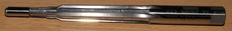

The custom production reamer from Pacific Tool & Gauge arrived today.
I will turn it around and ship to Larry.
Next on my list is the custom form and trim die from Redding. After that it will be a custom die set from Lee.

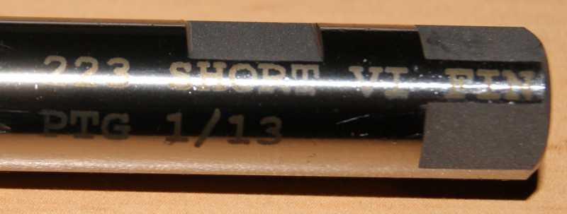

First barrel with the factory reamer is done.  Savage threads, tiny bit over 23 inches long with an 11 degree target crown, parkerized finish.  I will ship it tomorrow.  Now just find some sort of Savage action with a .223 bolt head and you are all set.  Larry
Offline trotterlg
  • Trade Count: (36)
  • Posts: 3978
Re: The 223 Short project.
« Reply #136 on: February 22, 2013, 01:25:31 PM »
Put the first (factory reamer) barrel in the mail today, A Savage threaded sporter weight Remington a tiny bit over 23 inches long.  Larry

Got the barrel today... beautiful, if I may use such flowery language...

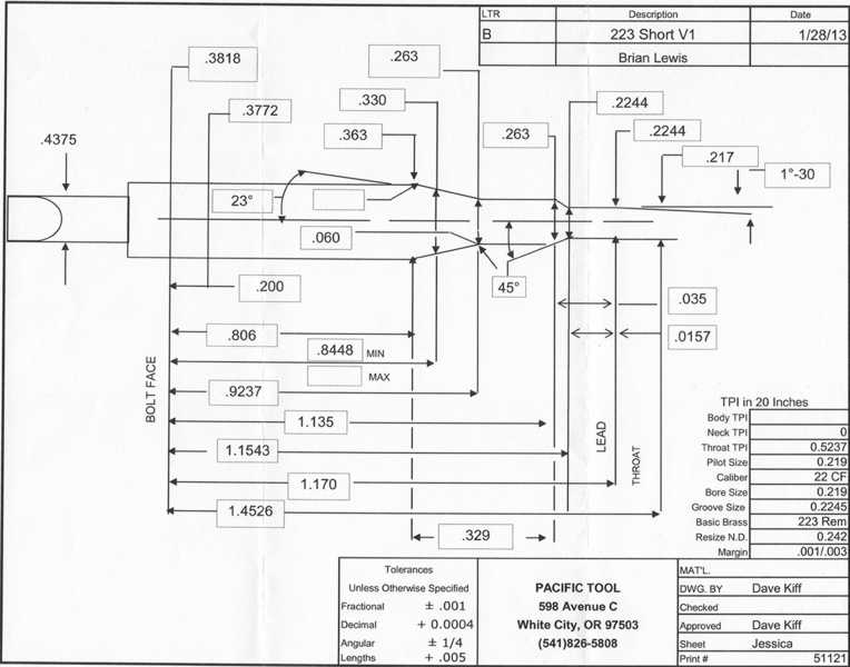

Here is the reamer drawing...

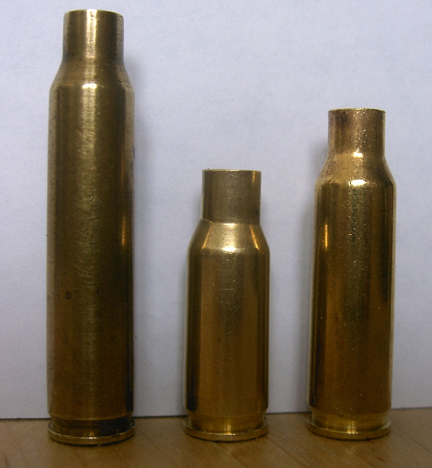

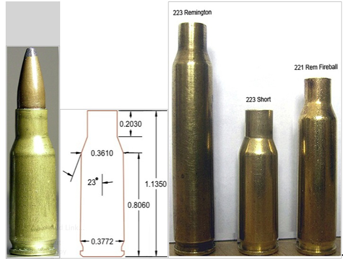

Jeds latest update. I am blown away that Jed has managed to form 223 Short cases from 45 223 cases without a failure.
I have asked him to form some 221 FB cases so we can compare the neck thickness to the reformed 223 cases. New 223 cases are $20/100 and new 221 cases are $45/100. I expect that the 221 cases will form better with less neck thickness than the 223 cases.
Hi  Brian,   I ran 45  223 cases thru the die and got 100 % of them to form proprerly.
I think we should keep the necks approximately the same as other 223's also as you suggested.
Most have about .012 neck thickness, I personally don't like inside neck reaming to reduce the thickness.
I have done it before and my results were that I ended up with variable neck thickness and not concentric with the OD.
I beleive that if we turn the outside down to about
.247 and we will be right at the same dimention as the parent case was.
If you end up using a Lee collet sizing die it touches only the neck portion and has a mandrel down thru the case and is centered by the reprime pin being in the flashole during the sizing process.
Once you have fired your brass for the first time in your new chamber it should be very true and concentric.
If you want me to turn the necks let me know and when I get them done I will send you 40 - 45 finished cases to get started with.
I think once you have about 100 cases it should last you for at least 1000 shots if you are neck sizing them.     Jed
223 Remington     223 Short     221 Remington Fireball

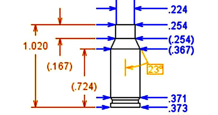

I thought this cartridge looked familiar. The true 223 Short = 22 TCM?
"The TCM cartridge fires a 40 grain jacketed hollowpoint bullet at speeds exceeding 2000 feet-per-second (fps) from the muzzle of a five inch barrel."
http://www.gunblast.com/RockIsland-22TCM.htm
"The .22 TCM cartridge was originally the brainchild of custom gunsmith Fred Craig. The “.22 Micro-Mag,” as Craig called it"
http://www.shotgunnews.com/2013/01/09/smallbore-slabsides-rock-island-armory-22-tcm-review/
The pictures below referenced from this link.
http://www.gboreloaded.com/forums/index.php/topic,276548.0.html
yooper77

We have seen these cartridges before, the difference is the goal was to fit the cartridge into existing magazines of pistols, the 223 Short is designed for rifles, and may end up being adapted to pistols, if someone can make a light weight but very strong action because of the 223 Short chamber pressures, expected to be just like 221 Fireball - as high as 50k psi.
To achieve fitting existing magazines (9mm) they leave the brass at .754" case length, compared to the 223 Short's 1.135". The case bodies are .391" in diameter, the 223 Short is 0.377".
The 223 Short can use 35g - 80g+ bullets. Overall Cartridge Length of the 223 Short with bullet is 1.635". The 22 TCM doesn't even come up to the top of the 221 FB case neck.
The 223 Short can kill a coyote at 300 yards, I think I read a little about adapting a rifle to use the 22 TCM.
These cartridges are different animals, and I applaud more people getting onto to the small & efficient cartridge band wagon.
Case Body Length - .806" 223 Short; 0.724" TCM
Shoulder Angle - 23ยบ Both
Neck Length - 0.203" 223 Short; 0.167 22 TCM
Case Overall Length - 1.135" 223 Short; 1.020" TCM
Cartridge Overall Length - 1.635" (or longer if the throat is cut to a diff spec.); 1.275" TCM
A Thompson pistol can be chambered for the 223 Short using a blank barrel, so can any other bolt action rifle.
However, it will require a custom pistol design to make it into a semi-auto form factor.
I love talking about this stuff as we move ahead.

Which software produced these drawings?
« Reply #145 on: May 17, 2013, 06:27:54 PM »
I have been looking all over and can't find any similar drawings. I've emailed Shane but I am not counting on him to reply.
Offline briannmilewis
  • Trade Count: (11)
  • Posts: 1017
« Reply #146 on: May 28, 2013, 03:04:52 PM »
Shane is back in touch and he is a CAD guy so he just uses AutoCAD for his cartridge drawings. I am exploring MacDraft so we shall see.
