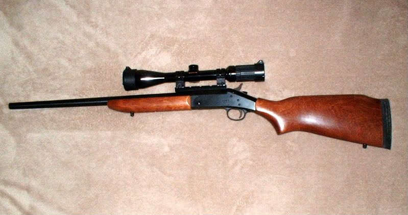

I made a trade deal for a 7-08 Handi barrel and don't know anything about the 7-08. By all accounts it's a good deer cartridge and that's what I plan on using it for. Other than that I'm at a loss. What are the pros and cons of the 7-08? What ammo recommendations do you guys have? Like I said... I need some schooling on this one.
Spanky

I have one in the Handi. Bought shells this morning on the way home from Doctor will be shooting in a couple of weeks. I bought Rem. CoreLokt 140 gr.

My wife has a 7-08 Handi & it's a tack driver. It took about 20 rds before it got consistant in grouping. It seems to like Fusion 140gr the best. 3 shot groups @ 100yds covered with a quarter. My son used it last week & dropped a 235lb hog @ 170-180yds.  Paul

From what you guys are saying I think it's gonna be a good one. I'm looking forward to some range time with it. ;D
If it shoots as well as my other Handi's I'll be a happy camper. ;)
