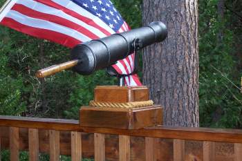

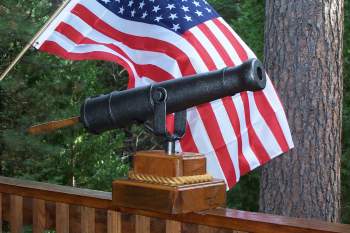

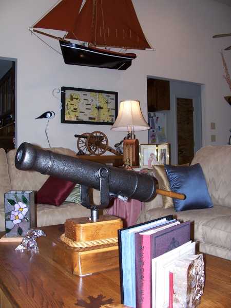

A friend of mine is turning his 3 car garage into a recreation room.  He has a big flat screen TV, a no hold-em polker table and a 13 ft. wet bar.  It is decorated in a southseas--Pirate theme.  Well, you can't have Pirates running around a bar that long without a swivel gun.  Ask Tropico.  Soooo I went into the shop and started wood chips flying, ala Zulu.  The first pix is of construction.  Stock that size really jumps around till you get it trued and balanced.
The next three are of the finnished product.
This one is to add character for CW.  I couldn't find anyone to dress up for the shot, so I volunteered.
Now the last one looks so good on our coffee table, I don't know if I want to let go.

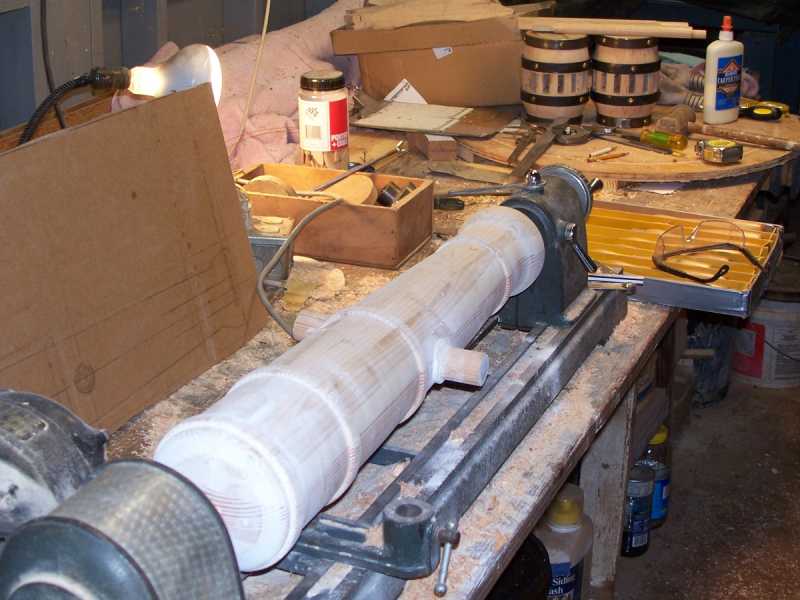

Div Arty,
Great job!  How did you bore it?  I am very interested in this because it is the hardest thing I do with my wooden cannons.  I have to guess that you used a forstner bit with the barrel vertical in a drill press.  You also couldn't go very deep.  Boring end grain is a slow process and dulls your bit very quickly.
What type of wood did you use?  I can see that it is laminated.
Give that one away.  Make another one. ;D

Wow!   Never expected a Kewpie for this craggy old face.  That pix was more of a broadside at CW.
You are correct about boreing end grain Zulu.  I didn't have anything but a Irwin expansive bitt for the 1 5/8' hole.  So with the help of a very large son in law to hold it down, I went at it with a brace.  The wood was just scrap.
