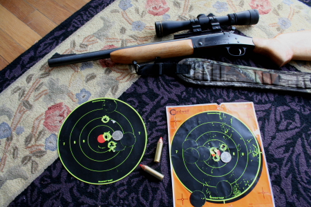

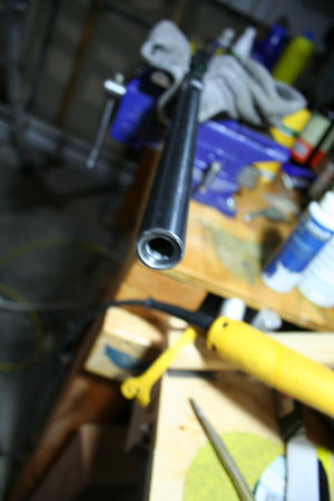

I recently cut down my 500 S&W to a little under 18 inches (cut it to 18.25 - but these barrels are so difficult to recrown that it took more than a 1/4 inch of cutting to get a half decent crown - still not happy with it).  I would love to post photos, but the new "my hosted pictures" does not want to work for me, even though I successfully created an account.  Anywho...I also made an aluminum pillar for the barrel screw hanger and I got a 30-yard off hand 3-shot group that you could almost cover with a quarter shooting Hornady FTXs over a moderate load of Lil Gun and loaded to the longest oal I could manage and still get a little piece of cannalure for a little bit of roll crimp (chamber is very long).  50 yard 3-shot groups off a Cabelas saddle type bag over a lose fence rail gave 1 shot high and then 2 very close together in every case.  I think I lapped the bottom part of lands/grooves further back on the bottom - giving an upward push - why just on that first shot is beyond me???  I would go for the 44 mag personally, just because the 500 barrel is made funny and hard to recrown.  If only I could post photos, I would show the hard outer layer and the soft inner barrel (as well as my targets) - all kinds of fun for your crown cutter!  Very potent little bugger, though!  About 33 inches overall length.

Offline guns-o-fun
  • Trade Count: (27)
  • Posts: 536
Re: The best shorty??
« Reply #17 on: January 01, 2010, 12:33:45 PM »
I uploaded to photobucket, but there code is not working.  Maybe the images are too large?? I will look at the faqs.  The gun certainly has acceptable hunting accuracy to 50 yards now, but I am going to work on the crown some more to try to eliminate that one early flier.  I am making my loads just as consistent as I can without a competition seating die - so I don't think that is the problem.  If I can pull in that one flier - this will be one awesome little thumper.  It is already short and light (you can feel it in your shoulder a bit too.)

Offline guns-o-fun
  • Trade Count: (27)
  • Posts: 536
« Reply #20 on: January 01, 2010, 03:41:37 PM »
OK - so if I could have pulled in that "flier" on the offhand group (target on right), you could have almost covered it with a quarter.  The other covered holes are from a 5-shot group of 370 CPBs over a middlin' load of IMR 4227.  The three shot group on the target on the left is fifty yards FTX over Lil Gun as are the covered holes.  The top photo shows the hard outer layer of the 500 barrel and the softer inner core.  Not great, but I am not there yet and this is a lot better than the gross scatter I was getting.

Spanky that 500 you got would make a heck of a high power carbine! I was going to go that route and still will when I get another 500.
As for light weight... have you considered having the barrel turned down to remove some material or even possibily fluting? Just a thought and I didn't see if anyone posted that idea.
G-O-F nice pics and rifle thanks for posting them up.

I have yet to see a flier that was caused by a barrels crown. A crown is a fine thing, I mean good bad or indifferent it does exactly the same thing to every bullet that passes thru it. While it has a major effect on overall accuracy, it doesn't cause fliers. It is generally good or bad. For-ends on the other hand are known flier causers. I myself am plagued with them in this caliber, but I feel mine are a different issue as I seem to have calmed them with medium loads, just backing off the pressures down to maybe 45,000 seems to make it a much better behaved caliber. Quick's recommendation of the excellent Ranger Rick 440 WFNGC hard-cast lead bullets and XMP5744 powder have made it a different animal all together.
I still need more range time as I am not satisfied as yet, I REALLY want it to shoot a jacketed bullet and I would LOVE it to be the Remington 385HP as It seems very good and the price is half other offerings....
BTW, Photo bucket new software auto adjusts image size to a usable level automatically. I send my pics from two different cameras. My reg camera is a Nikon Cool-pix of 4MP, my quality Kodak 6PM. This thing makes huge pics, I cannot email them without compressing them! But photo bucket downloads them just a tad slower then the Nikon's and I don't do anything different. Now I just remembered, I do have a paid account, (Pro account) so the free account may not have this software.

  • Trade Count: (27)
  • Posts: 536
« Reply #23 on: January 02, 2010, 02:07:28 AM »
CW
Thanks for the input.  The 1" aluminum pillar I inserted seems to make a difference.  It may still need some adjustment, but the forend locks up nice and tight without any barrel contact anywhere but at the pillar.  These shots are not from a real rest, but just improvised stuff and off hand out in the "yard."  I need to get to the range and use a real rest (and take along my chrony).  The forend may well still be a problem, but frankly, I think that the loooong chamber on this beast combined with occassional slight bullet runout could do this too.  The Ranger Rick bullets do look like they would use up some of the excess free bore, though.  Have to give them a try, along with some of the longer medplat Beartooths.

Offline blind ear
  • Posts: 4156
    • eddiegjr
« Reply #25 on: January 02, 2010, 03:26:28 AM »
Guns-O-Fun, I have been thinking the same as CW stated. I was wondering if the series of events before you fire the first shot puts the gun in an unstable position and the first shot settles things back together. Just a thought. ediegjr

Offline guns-o-fun
  • Trade Count: (27)
  • Posts: 536
« Reply #26 on: January 02, 2010, 04:41:13 AM »
You might be right.  I need to make sure that the contact on my pillar is as even as possible.  Also, right now, the pillar is just held in place by the forend screw tension.  Things may improve if I anchor in the pillar with a little acra glass.  Still more to do.  Getting close though, and if it were not for those fliers, the gun would be shooting great for a 500!
Offline cwlongshot
  • Trade Count: (158)
  • Posts: 9907
« Reply #27 on: January 02, 2010, 07:12:01 AM »
 I like your idea of a pillar for the for-end. I have had similar thought floating around in my head for some time, but never really tried any...
 I have also herd it said the the forend screw shouldn't bottom out... not sure of the persons take on why... But I have the long mannlicher forend on my Maxi set up to bottom out as the forend snuggs up and it shoots very well. On the 25/35 I just got form Larry, he included for me a forend screw. I tossed it in the handi parts drawer and fit another longer screw so it bottoms the same way as the one in the maxi. Time will tell if this is a good or not so good idea.

Offline guns-o-fun
  • Trade Count: (27)
  • Posts: 536
« Reply #29 on: January 02, 2010, 09:53:43 AM »
I would bet the 44 is made from a standard barrel blank and should be a piece of cake to recrown.  In spite of what H&R told Quick, photos don't lie (unless doctored - and this one is not) and my 500 barrel has a hard outer layer that is noticeably harder than the inner barrel.  This is no standard barrel blank!  BTW, as far weight goes - with the reduction in barrel length by a little over 4 inches and the fact that I skeletonized the butt stock a little, the weight on my 500 has come down enough to feel the difference in heft.  In fact, I now have it double padded with a Limb Saver slip on.  Adds an extra inch of pull, but I have long arms for my height and the gun really accelerates in recoil now, so I need it.  Do get a touch of bursitis in that right shoulder on rare occassions.  Terrible thing getting old - but better than the alternative!
