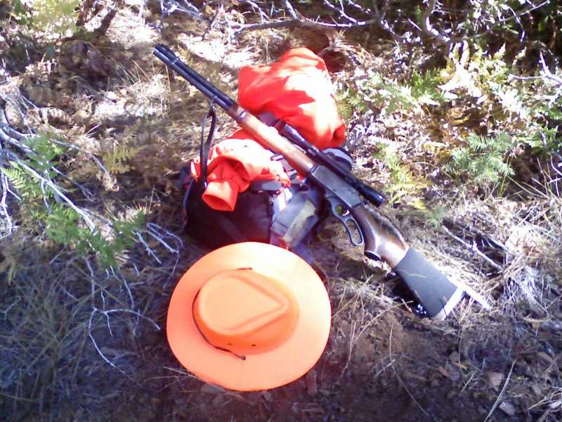

I have a Marlin Model 336 which was sold as a package gun with iron sights and a 4x scope.  The iron sight was sighted in long ago and forgot because I prefer the scope.
With my eyes I could not have shoot this group with iron sights.  The Marlin is now wearing a 2-7x35 Burris.   Top two are factory Remington 150-grain, the bottom two are my Hornady 150-grain Roundnose reloads.
The tough one for me and the jury is still out is not scoping my Jungle Carbine.  I am happy with the peep sight for close range shooting.  Good commercial scope mounts are made for the rifle, but I want to have a rifle with iron sights for those super nasty heavy rainfall days.  Most shots are within one hundred yards and I do okay at that range with a peep.  I am writing about one of those days that you are exhausted from being in the rain.
This fall I hunted about a week with the scope equipped 336 Marlin.  The light rain and snow came down a couple of days.  It was not enough to bother the Burris scope.  I was pleased with the scope/Marlin combination.  If the conditions deteriorated enough I could have removed the scope from the base of the Weaver mounts and put the scope in my day pack.  It did not get that bad.

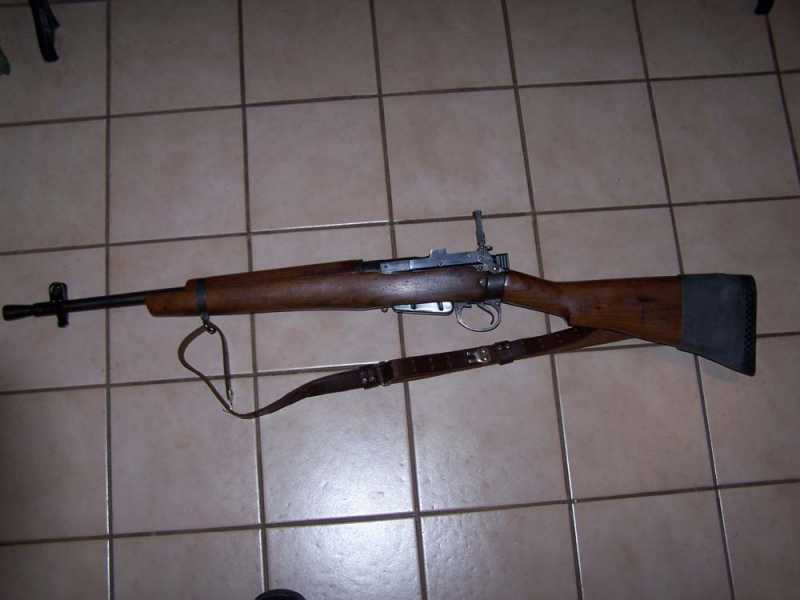

When I shoulder a rifle with a peep sight my eye picks up the center of the hole/light, in my mind the peep sight is out of focus and the eye focus on the foresight (front) and the target.  Focusing on the peep, the foresight, and the target is a complex process for the eye.
I do not mind using a peep sight on the right rifle.  This one has one in the ladder sight, and when it is folded down the user has the use of another peep sight.
