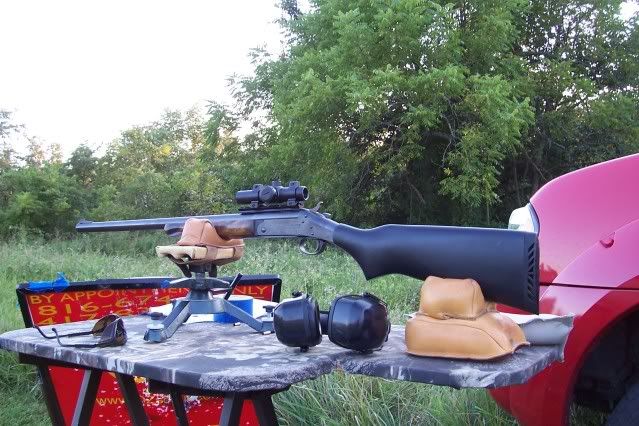

Here is the rifle, kind of a Frakenstocked.  ;D
