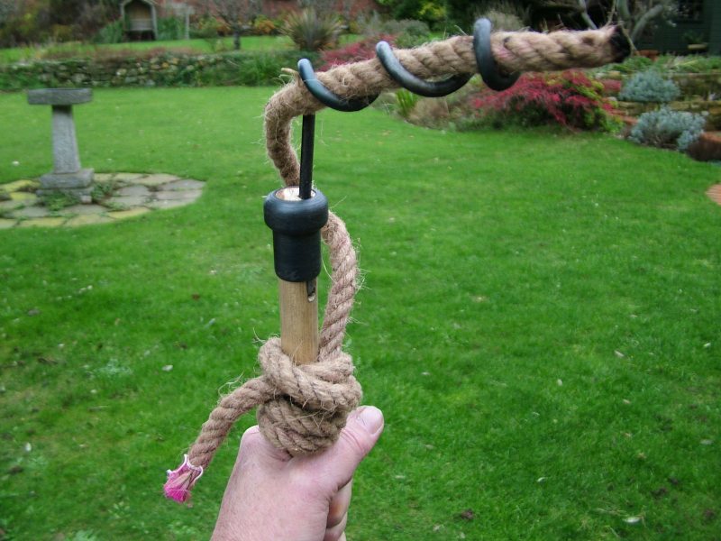

Day before the shoot I finally do it  ::)
Meant to do it simple, got to the workshop, couldn't find anything to make clothes pins out of, had to make it with what I had ;D
Thanks for all the suggestions, these linstocks are durned curious things  :o

« Reply #13 on: December 05, 2009, 03:13:56 AM »
Looks perfectly functional to me, Squire. :)

When you use the thing ,I'd suggest going at it kinda flat In Mont. I used mine and the first try or two I was comming striaght down from the top .
It went off ok but each time it blew the ropes into its respective twines ! Much agervation and grief comes next !!
Some excess BP at the touchhole /vent tray helps alot as even our quills take alittle help usually .
YMMV

Nice design Squire. Looks like you have the proper size match also.  Some use match that is too small and wind up wiping it around the vent to get it to work.  Probably the first lesson one learns when using a linstock the first time is not to hold it over the vent.  The next lesson is make sure the match is snuffed out after shooting.  I found that a couple of turns of wire wrapped around the match will usually act as a safety and snuff it out when it burns to that point, at least it works for me on cotton match up to 1/4 inch diameter.

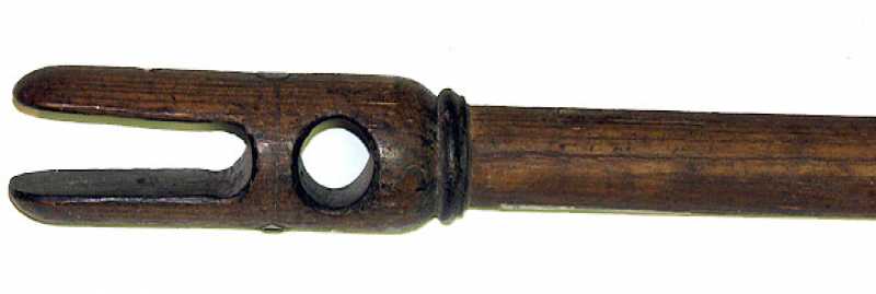

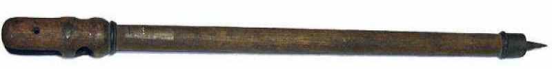

« Reply #19 on: December 09, 2009, 10:20:51 AM »
Here's an original I just found thanks to DD:
http://www.guns.uk.com/store/shop/shop.php?action=full&id=265
