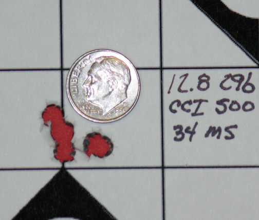

I have shot both the 34 grain .224 and 50 grain .224 bullets. In a Handi that is a re-barreled (Douglas stub) 22K Hornet I got these groups using the 34 grain Mid South bullet. The Handi platform is not the best for accuracy - These bullets would do even better with a good bolt gun. Of course this is plenty accurate enough for it's range and it's intended use. Loads are listed on the target. I have shot them some in a Savage Model 40, but haven't done so enough to see if they are going to work out... I need to do more load development - but they look promising. BTW I got 500 to start with and then ordered 1000 more - can't beat the price and they shoot good too.
I have used the 50 grain nightmares in a Remington 700 that I re-barreled myself to 221 Fireball. I do not have any pictures of groups with it, but it will make 1 hole groups at 100 yards real consistently. They make the above groups look bad. Once in a while I get a flier that opens the group up to .5 -.6, but I blame that on me, not the bullet. I use RL7 and Remington 7 1/2 primers. I have shot a few
I have also used this bullet in a 23" T/C 221FB barrel. I consistently get groups under .75" with it and once in a while I will get a .5" group with it. I use a lighter load of RL7 for this gun. I have shot a few woodchucks with this gun/bullet (it is so easy to carry). I find that at 221 velocities (2900 fps muzzle); that I get a pass through. I have never lost a 'chuck due to this. The entry hole is a normal entry hole the exit is about the size of a nickle when shot 75- 100 yards. Some times I get an exit hole and some times not; if shot under 50 yards.
I have not done any testing with the 50 grain bullets in my other guns - yet (a couple of 223s, and a 22 BR). I will be getting around to it this spring. I bought 1000 of these to start with (because of price) and liked them so well I got another 500 so my supply is back up over 1K.
