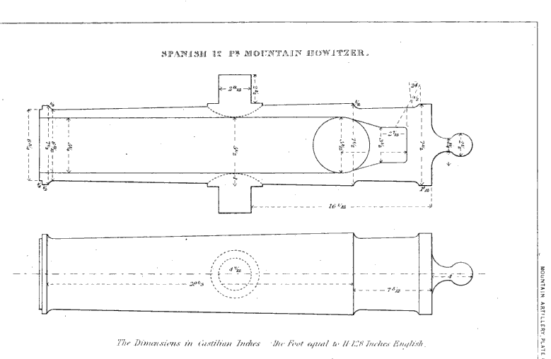

The Spanish model (according to this Aide-Memoire) is derived from the French mt. howitzer.
I've seen a few examples of the Spanish mountain howitzer dated in the 1840's which appears to have been derived derived from the French design, but the Spanish pieces definitely had centerline trunnions.
C/L trunnions seem to have been preferred by the Spanish on about all of their bronze weapons manufactured in the two royal cannon foundries in Spain, beginning at least as far back as the 1780's.
Spanish weapons cast in their colonial foundries (Philippines in particular) did not necessarily follow the centerline trunnion idea.

This drawing of the Spanish 12-pdr Mt. Howitzer shows the trunnions placed on the centerline of the bore; also notice the taper of the barrel, and the different muzzle design, as opposed to the U.S. version of the French mountain howitzer which (other than the trunnion placement being altered) basically duplicates the French original.
Spanish Howitzer
Douglas; notice how the projectile rests in the front of the chamber. I thought I had a photo of an example of fixed ammunition for the U.S. M1835 Mt. Howitzer, but I can't find it now.

« Reply #16 on: October 12, 2009, 07:15:43 AM »
Yes, I think the fixed charge is shaped like the taper and chamber.

« Reply #17 on: October 12, 2009, 11:40:18 AM »
isnt the tapper part for a sabbot ??
Re: M1835 U.S. Mountain Howitzer
« Reply #18 on: October 12, 2009, 12:01:31 PM »
Yes I believe it is.
« Reply #19 on: October 12, 2009, 02:00:44 PM »
Here's a PDF that shows examples of shell, case shot, and canister fixed ammunition for the Mt. Howitzer.
Plus the enlargement to about 300% so you can get a decent look.
