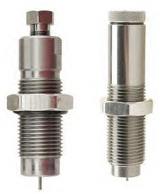

I would be curious on what Lee die you are using. What are the markings on the side of it? Are you sure you are not using a Neck Collet die?

It is stamped Lee 270-J8

The LEE full length sizing die on the left and the LEE collet/neck sizing die on the right:

My die is the full linght sizing die like the one on the left.
