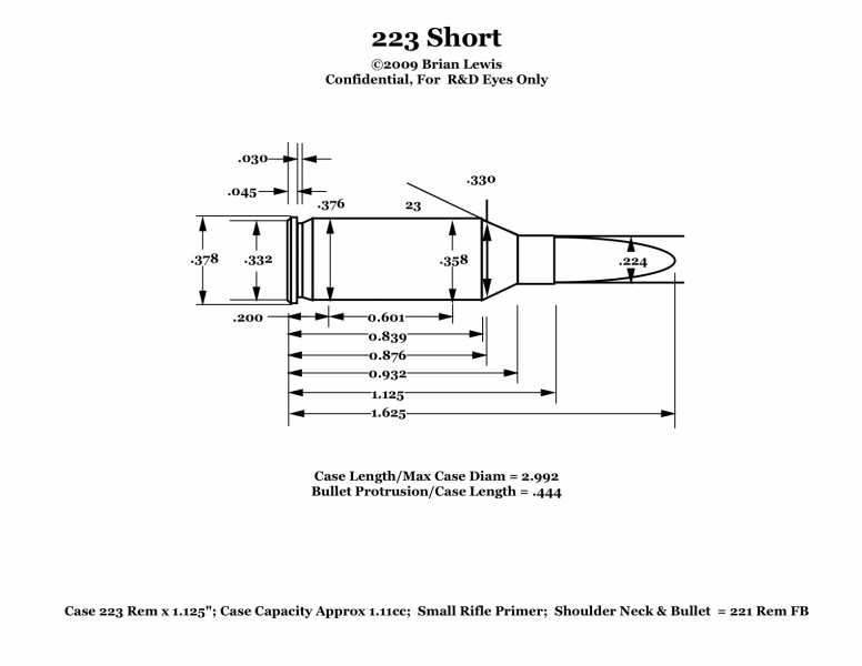

Folks:
Some of us GBO folks are working on developing a 223 Remington Short, see the attached drawing.
Considered opinion is that WE DO NOT use Remington in the name.
The ultimate goal is to also have .172, .204 and .243 versions, all using a 223 Rem Short parent.
So I need a name that fits the cartridge.
This is where you come in.
I need suggestions for the name BEFORE I can run a poll to get as close as possible to the best cartridge name.
There are some obvious ones like 223 Short, 223 Express, 223 Midget, 223 GBO, you get the idea.
I don't want to run an unofficial poll in this thread, so if you see your name already submitted, don't add an entry like, "Yes, what Larry said." Just think up another name and submit it.
So let's see how it goes.

That round would be just about the same as a .221 Fireball. Make it a few thousands longer and just form fireball case.

Catfish: The Fireball is on my personal short list for rechambering a 22 Hornet but it didn't meet my goals.
The case length is .400" shorter than the 221 Fireball.
One of the design goals was to use about 1cc of powder, which is 25% more than a 22 Hornet and 33% less than the Fireball - 500+/- rounds per pound of powder.
We are ultimately trying to fill a gap in performance between the Hornet and Fireball, using a modern and popular parent case design.
Thx.

I've always filled that gap just fine with the 218 Bee and 22 Rem Jet.  ;)

Ladobe: A design criteria was "using a modern and popular parent case design". I am going to do my own Bee and Jet down the road, just for nostalgia and help keep them alive.
One of the design goals was the wildcat has to be easy for everyone to make themselves with their existing equipment or with only a modest extra cost for non-custom dies, all from cheap and plentiful brass.

Skunk: Historically, using the designer's name is really par for the course when it comes to wildcats. If that is what a poll determines, then I will go with it.
What I think may be out there floating around in the wildcat ether is a name that really captures what I tried to design.
There is a 22 Reed Express, which uses a Tokarov 7.62x25 cartridge and necks it down to .224. Reed is the designers name and I sort of like Express, even though in the past I think "Express" has been associated with large caliber cartridges.

there is nothing new worth comming up with wilcat wise unless you neck down a 2 bore to a .22 and you can call it a 2222 2much
The only measure of success for me will be a good implementation of the round, and folks being able to make their own ammo with minimal investment, staying clear of forming dies and all the other expensive stuff that typically goes along with a wildcat.
The idea for the round came about by me being on the lack of cash end of the shooting game. The round is not designed to out shoot any of the barn burners, but the goal is to do a good job, using as little powder as possible, and being able to make the brass for it really cheap. I don't think these are the typical design goals for wildcats.
Point was, new cartridges are usually designed to fill a niche that is not filled.   This one is filled by several cartridges, both commercial and wildcat.   Brass is readily available as are dies for all of them.   So you are trying to reinvent a wheel that doesn’t need reinventing.   The hordes nowdays just seem to want to tack a name on a proprietary cartridge.     ::)
As GB said, the commercial end is not anything you'll need to worry about.
Point was, new cartridges are usually designed to fill a niche that is not filled.   This one is filled by several cartridges, both commercial and wildcat.   Brass is readily available as are dies for all of them.   So you are trying to reinvent a wheel that doesn’t need reinventing.   The hordes nowadays just seem to want to tack a name on a proprietary cartridge.     ::)
Commercial is not one of the design criteria. I want people to be able to make their own cases with little or no further investment and really cheap parent brass.
The overriding idea is to fill a niche that may be filled by others, but do it dirt cheap, both to setup and feed over tiem, to get a 200 yard coyote gun, as I don't think a lot of shooters want to pay $65+ for one or more forming dies, then new FL Sizers etc., when their exisiting equipment will do the job just fine.
There is a big difference between "available" and "cheap" or no additional reloading hardware required. Same is for brass, 218 Bee and 22 Rem Jet brass may be "available" but it is not $9-$20 per 100.

My question is are you trying to make it short so it will fit in a certain action.
And if so why?  most 22 Mag actions are not strong enough for what you want to do and anything that will fit a Hornet will fit a 221.
What will it do that 221 loaded slower will not be able to do?
