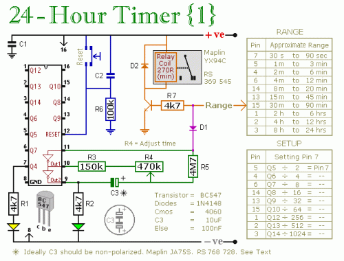

Matt these schematics look great... if I were a electronics tech :o I work on ac and refrig and heating. I've worked on a lot of mechanical equipt, I mean a lot! But I'm gonna have to do a lot of study before I can decipher those schematics.
Offline Matt
  • .:{º.º}:.
  • Posts: 2130
    • Inkredible Image

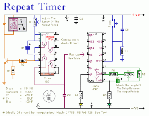

Re: Improve My Deerfeeder?
« Reply #6 on: September 20, 2009, 06:53:35 AM »
Here is what it will look like when you are done with the repeat timer
Matt
Any fool can know. The point is to understand.”
― Albert Einstein

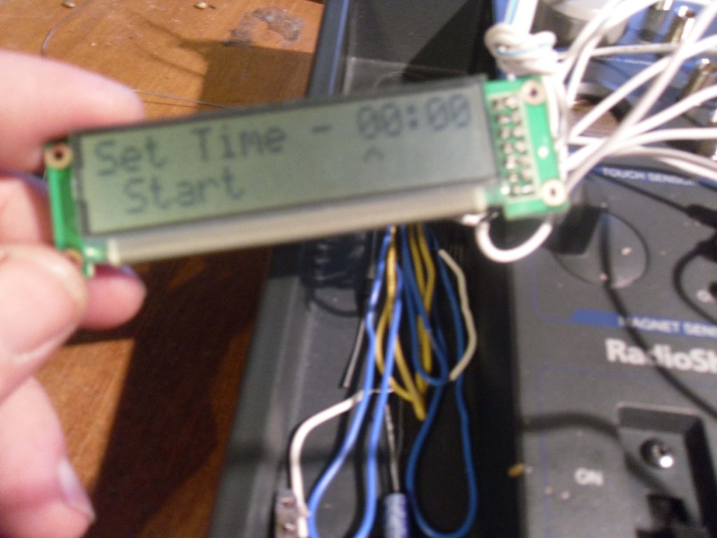

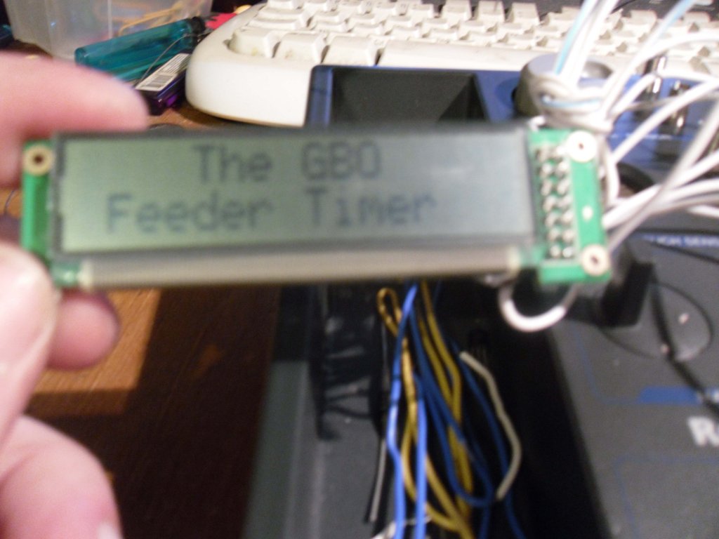

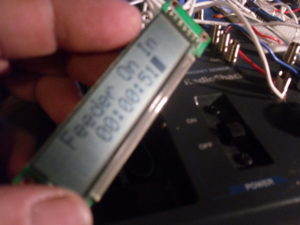

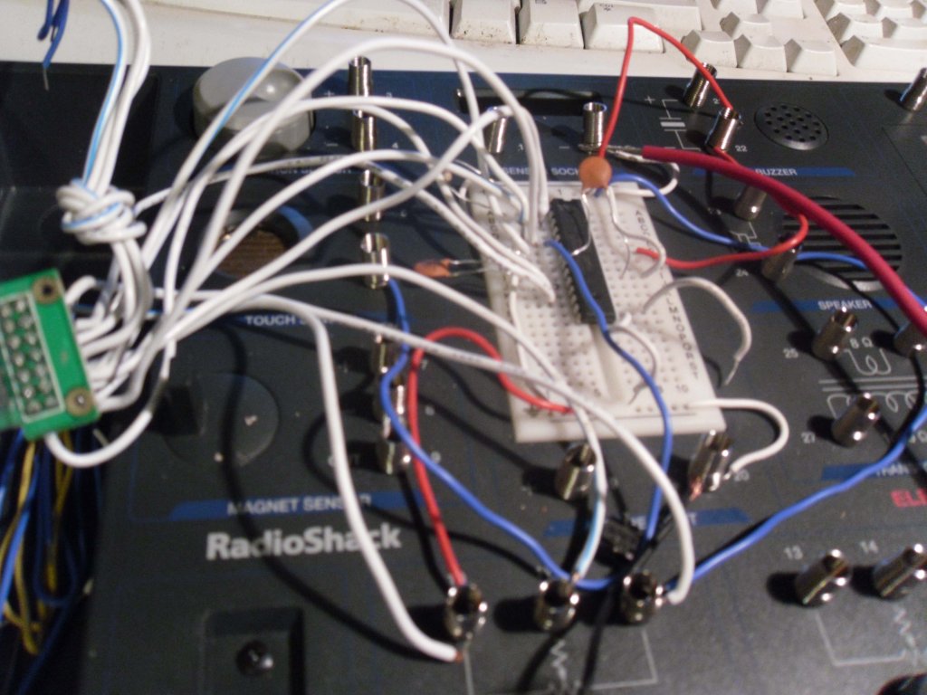

Ok here is a little timer I put together:
Uses a ATmega8 AVR
2 10nf caps
1  1k resistor
1 10k pot
3 push button momentary switches
1  16x2 LCD module
Total Cost: $9.00
I wrote the software for the AVR in C but it is still a bit buggy and needs another function added to set the duration of activation.
Here are a few pics of it in action:
Boot Up:
Time Set:
The Count down:
The circuit on my small breadboard:
I will be working on the code and will publish the schematic for it just as soon as I can get a chance to draw it out.
Comments Welcome....

Offline Matt
  • .:{º.º}:.
  • Posts: 2130
    • Inkredible Image
« Reply #21 on: November 24, 2009, 10:55:00 AM »
Here is the code I use for the LCD. IF you use AVR Studio then you have all the needed includes.
