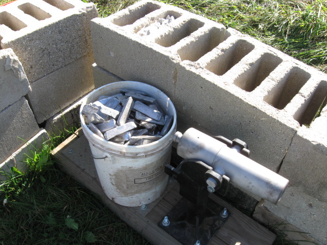

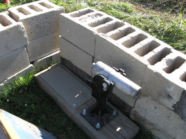

Ok , here it is , the final shot in this test .
The Naked Gun 44mm
This time I added 200lbs. of lead to the base .
The load , 1100 grs of 4Fg BP under 5 1lb. lead balls
AS you can see my tube survived .

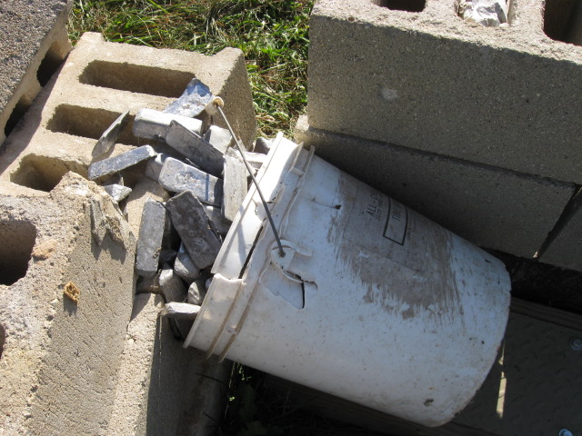

My test base didn't

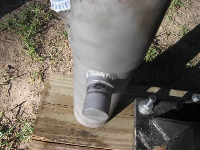

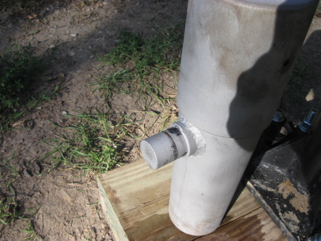

The trunnions are intact
With only minor damage . No cracks were visible , even after a dip in acetone . Armorer77

Evidence that overbuilding or using good rules-of-thumb is GOOD.
It's a good half of the equation.  Part of the rest of it is firing a 1000 times with moderately overloaded charges - but who has the time?
This is good news for that 'accidental' overcharging.

 One rule of thumb should be "It's dang hard to beat solid steel for safety in a cannon barrel."
 I doubt that a cast iron barrel of similar dimensions with a 3/8" wall steel liner would have withstood 1/2 of that load.

it would be very interesting to see if any manufacturer of cast iron would dare to do such an test
or even with a sleewed cast iron barrel
I guess they just dont dare to do it
or at least not show the result as open as you have done it here
but you have for sure showed the quality of your pieces
with normal charges of fg and one ball there can probably never be any accident with your barrels
if they dont point it in a stupid direction  ;D
you have really try to have it blowing apart now
without any success  ;D
you are a low scum of the earth demolition man
but a he-l of a cannon builder  ;D
I guess that its not possible to do it better then you do
