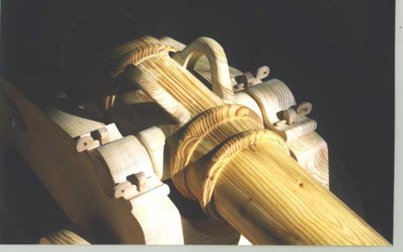

These are a matched pair of British  Light Six Pounders that I made out of 2 X 12's from Home Depot.  I have a lot of hours in them.  They are full scale with 55" barrels with a 3" bore.  The carraige is a 1600's garrison carriage that I copied from a picture in Round shot and Rammers.
they are very cool and live in my house.

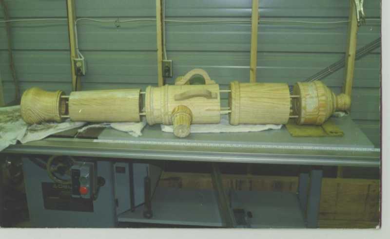

By now some of you have figured out that all the wood necessary to make a barrel like this,when glued together, would weigh quite a bit and be a heavy load for a lathe.  I have the biggest lathe that Delta makes but it wouldn't handle that kind of load.  So I came up with this idea.  Make it in sections and peg it together.  It works great for barrels that have a seperation point.  It does not work for barrels like an ordnance rifle because you could never hide the splice.

« Reply #10 on: October 21, 2009, 08:39:09 AM »
Double D,
Your comment above is one of the best compliments I've ever received.  Since then I have been working on another gunade (or carronade with trunnions) so you can see how one of these comes together.
Here is what I have so far.
Raw materials
glue together
ready to trim
trimmed and ready for the lathe

« Reply #13 on: October 21, 2009, 08:52:11 AM »
This is what I have finished to date.  Now that the easy part is finished the hard part begins.  Boring is tough work.
I will keep pictures and post as I make more progress.
