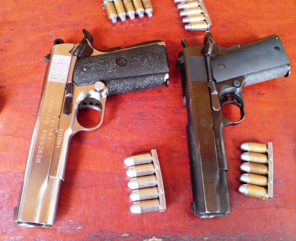

I have a Norinco 1911A1 45acp and so far I´ve just welded up the front sight and did a trigger job on it.
Used the original hammer, sear and disconnector but cleaned them up and honed the right angles on them.
I also fitted a flat mainspring housing, a STI trigger and a Clark 4-leaf sear spring.
The barrel has a sloppy lock-up and the barrel bushing has too much tolerance so I will be fixing these things this winter.
Been shooting 154gr SWC and 200gr SWC in it and only had a slight feeding problem with one magazine, adjusted the lips and that solved the problem.
The Norinco is like a Ruger, basically a good gun but they need a little work to be really good. ;)
Did some Ransom-Rest testing at 25meters >25yards.
5 shots 154gr SWC.
5 shots 200gr SWC.
I´m hoping for better accuracy when I´ve tightened up the barrel lock-up.
Left, Norinco European edition. Right, Norinco 1911A1 (mine).
