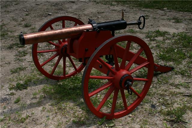

Confederate Breech-loading Hughes gun. AS yet unfired. (someone put the vent in to far.) Manufactured in 1861 to fire a miniball type projectile by bag charge with musket cap ignition.
  The ammo boxes that go on the axle are not yet complete.
Barrell 48.5 long, 1.5 * bore.
I know breechloaders are not liked here so feel free to remove this post.
Bob.

Looks good! I hope you took some production photos and plan on shareing.........  ;D
the copper is a water jacket if I remember, right? If so it was probably the first water cooled
gun until the Gardener came along, as far as breech loaders on this board any pre 1898 are fine.
and civil war breech loaders don't fit ATF parameters so post more on this gun.
I would like to see close ups of the breech, and how the breech locks up.

  I'd be afraid that if I posted production photo's, osha would find us and I would have no place to play.  ;D
Sorry ,I don't have a single picture of making them. My son has some that I may be able to post on his return.
Copper water jacket is right. You can see the fill hole about 2" in front of the trunnion ring on top of the barrel.
Since my computer was eaten by the google virus, I have not ben able to size photos or I would post some of the original bolt. It has 2 lock lugs which rotate behind stops in the reciever.
  The e-screw operates from under the trail by a wheel that ties to the barrel by long straps.

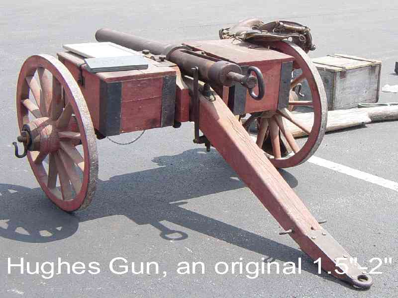

Photo of the original gun.  Sorry, the only one that will fit.
Bob

That's pretty cool looking! Nice job. It's always interesting to see how many different types of cannons there were!

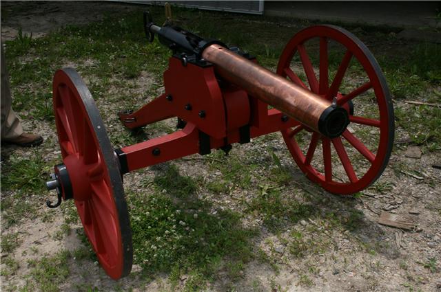

Guardsgunner sent me these to post I think he was concerned they were too
big but I didn't want to shrink them too much and loose the detail.
O.K. here is a question is the percussion nipple supposed the be the thing on
the top right side of the trunnion? If so how was it fired? slap hammer?
big mallet Wile E. Coyote style?
Offline guardsgunner
  • Posts: 421
Re: Near completed project
« Reply #12 on: July 31, 2009, 03:37:27 PM »
Kind of like a hidden lock. Hammer on a string like this ,kind of.
you can see what we used in the top photo.
Thanks for posting the pictures.
Bob

   Actualy what you see as seperate blocks is where the upper portion of the barrel has been milled away making the breech end of the barrel U shape. The very back of the barrel forms the front of the slot for the lugs. The main part of the reciver is bored square to the point at the rear of the area for the lugs. Dont know what the hole is the bottom of the slot but assume it is for a safty of some so that the lugs cannot rotate; Or at least it is on ours now.
   Fired today, breech does not leak. Sorry , camera sitting safely on my computer desk.
